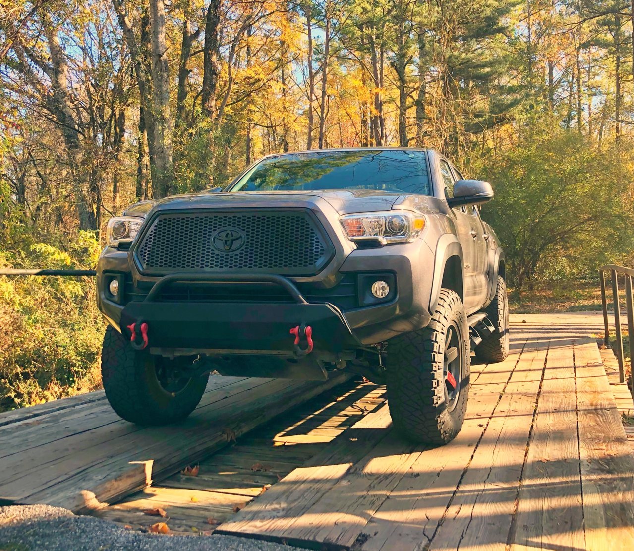

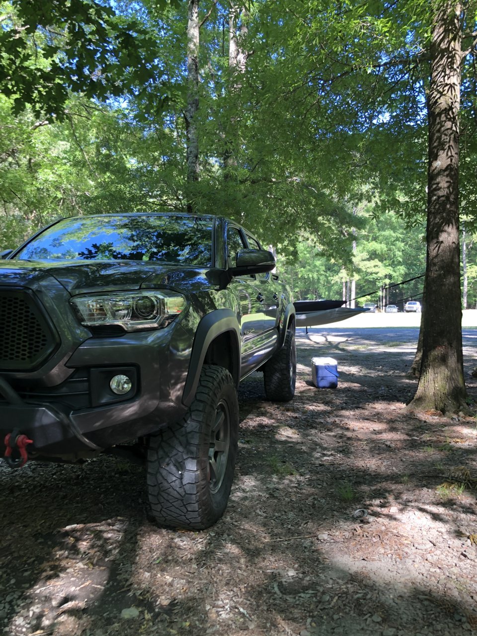

    Bilstein 5100’s with ome 881 coils on lowest setting, JBA upper control arms, LCE header, 31x10.5x15 falken wildpeaks.
    Might not help but these are @FreshOldTaco level 8 mk6 16x8 -10

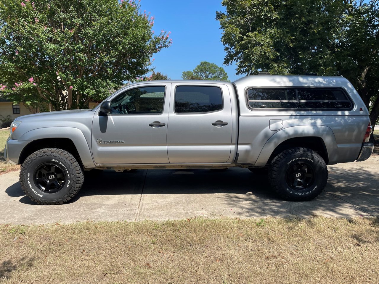

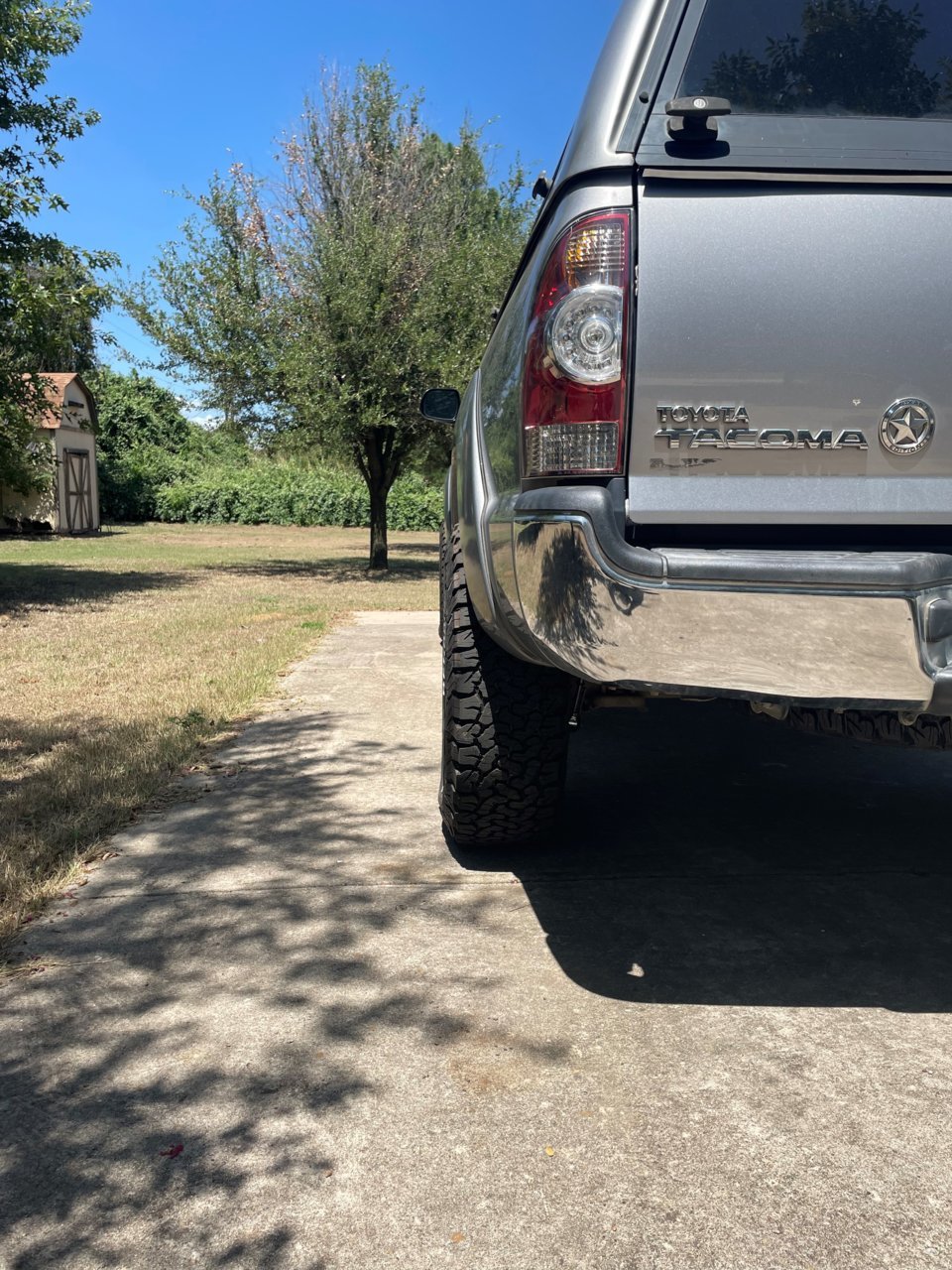

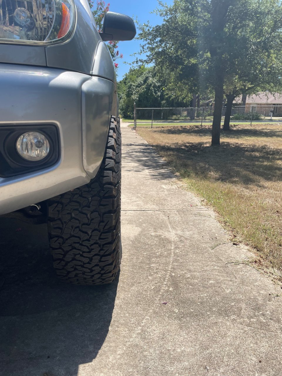

    Level 8 MK6, 16x8, 6x5.5, +0 Offset Rims 285/75/16 (33") BFG KO2 tires 4.56 Gears from ECGS DIY bed/drawer slideout Bed Mounted Deep Cycle Battery/Fuse Box/Inverter/Isolator Yellow Wire Mod Rear Diff Breather Mod DIY Roof Rack Leer 180 Shell Bilstein 6112, Circlip #4 Bilstein B8 5160 Remote Reservoir Firestone Ride Rite 2407 Rear Suspension Airbags DayStar Cradles Camper Shell Radiator Fans for sleeping in warmer climates
    If you're going with stock tire size, it won't matter too much. The -10 will bring the tire away from the truck about 0.4". Based on TW recommendations, I went with the 16x8, +0 in order to get 33's (285/75/16 KO2) to not hit the cab mount when turning. It has about 1/4" clearance, but I also have about a 2" lift in the front)
