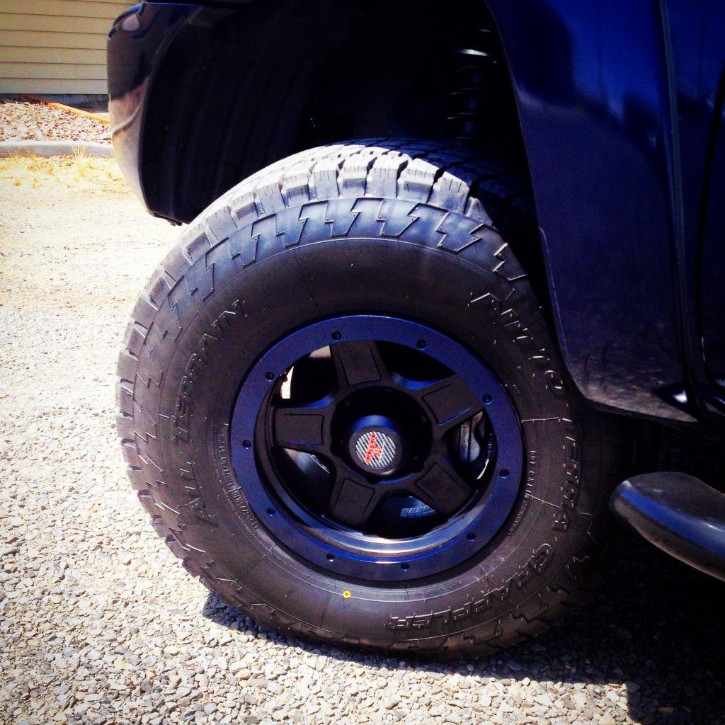

    Stacked spacer lift, 22x12 wheels with stretched 33's, tow mirrors, bull nuts.
    No mods, popped the old ones out and the new ones in. Good to go!

    I colormatched my "scratch guards" on my level 8 zx's

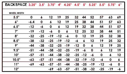

    Yes, they should they are 8.5" wide and -6mm offset, so that makes it 4.5" backspace, they'll stick out a little more since more negative is more far out

    Use this chart
