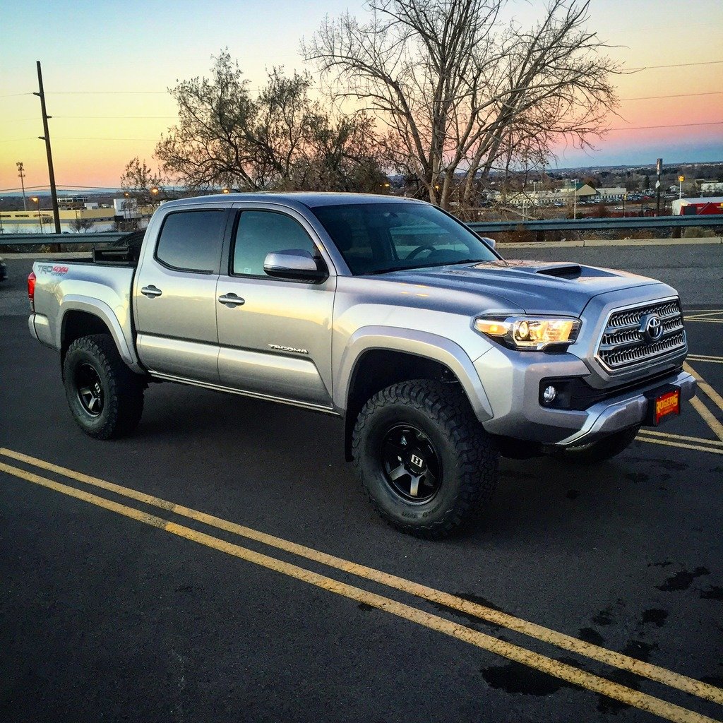

    and i stuck with level 8's just went to mk6's A272F693-C527-4F75-A631-1A48186D25C6_zps_d87182b1df9946e5a30a871ccdb66cdf1346b1b2.jpg

    Look great. What size tires and any lift or level?

    285/75/16 with the wheels at a 0 offset, and billy 5100 kit from toytec

    so the rims are 8.5" with a 4.25" backspace? what type of rubbing is there? this is exactly my move, but with level-8 striker-6.
    your blue Tacoma has TG's though ??

    No rubbing that ive experienced. full lock either way. Its tight, but nothing

    Where did you buy your level 8's at??

    discount tire. 125 a wheel

    nice wheels and tires, looks clean on the truck.

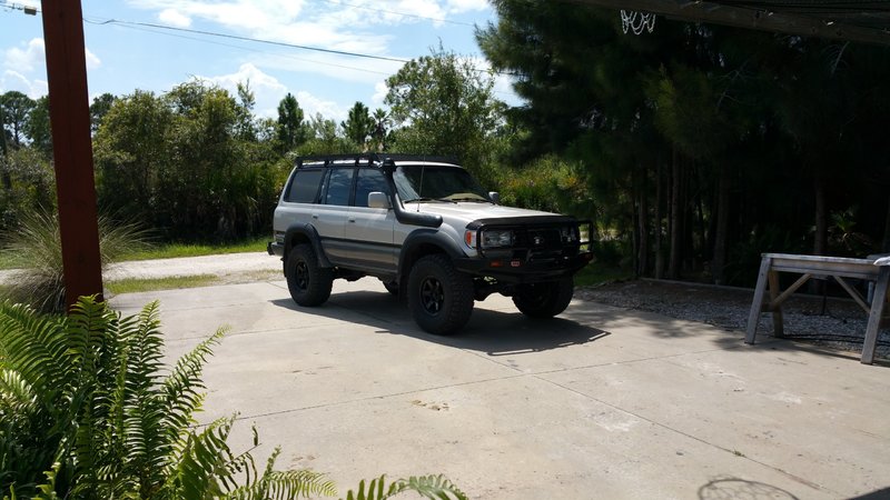

    I used them on my 80 series Toyota LC Should have bought 17" instead of 16" had trouble with the wheel weights hitting the calipers. Taped kind on inside of rim. 20150922_120130.jpg

    What offset did you get your wheels in?
    What lugs did you use?
    Thanks!

    if your asking me it was 0 off set. from what i read they only come 0 off or 30 off set and they are closed end nuts (acorn) from advance auto (dorman #711-346 m12 x 1.5) you'll need two packs
