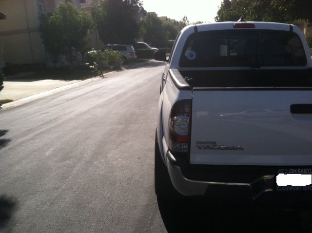

    Problem solved. I tested the hub rings for the fronts wheels and the shaking of the steering wheel went away. I then removed the hub rings and reused the caps that came with the rims. This time, I noticed the edges of the cap has some 3 spots (by design for a tight fit) that stick up a little bit. I used a hammer and knocked them down a little so it would sit flush to the hub. I ended smashing one too hard and bent one but was able to fix it.
    Lesson learned, do not work on stuff during the night time and weekday :). Sorry for the bad pics since the rims are dark.
    The rims are Level 8 ZX 17x9 0 offset with stock tire 265/65/17. The tires stick out about one finger pass the fender.
