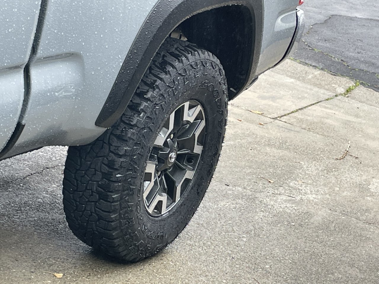

    Beautiful! Top notch, as always. I just threw on some 265/75/16 GY ultraTERRAINs on the stock OR wheels as well, they really wake the truck up. I’m trying to decide if the level is even still needed. Ugh. Decisions decisions. Happy holidays, gang.

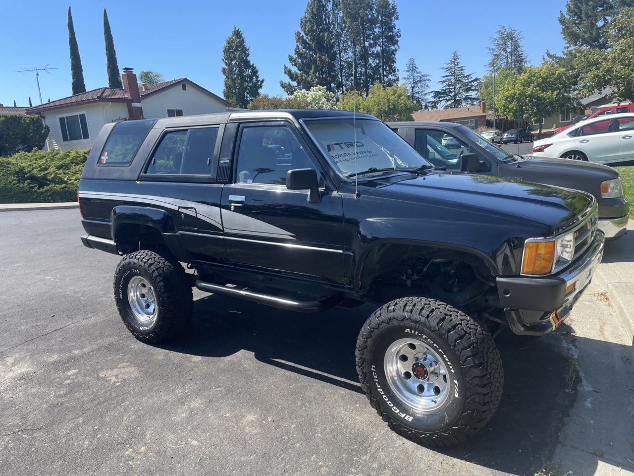

    Thanks for all your input guys. I use my f250 diesel for all the man stuff, ha. The yota is for HS nostalgia and awesomeness. But it will only see occasional DIY hauling and Tahoe trips. I regret selling my HS pickup but I kept my HS 4Runner. Love these yotas!
