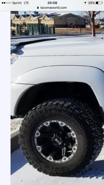

    Id see if you have quicklift ranchos.. they might be raised already. I cant tell what tires you have but based on what youre saying and the pics, you got more than 2 inchs goin on there

  20. Dec 14, 2016 at 7:10 PM
    #40
    Koitz
    Koitz Well-Known Member
    Sep 15, 2016
    #197378
    691
    2016 TRD sport 4x4 DCSB 2" lift 285/65/18 and loaded
    2" lift,18"rims, 32" tires,pro shifknob, black emblems etc
    This to me looks like a 2" lift
    Your tires r not true 32" their about 1/2" smaller give it or take (depending on the brand )!
