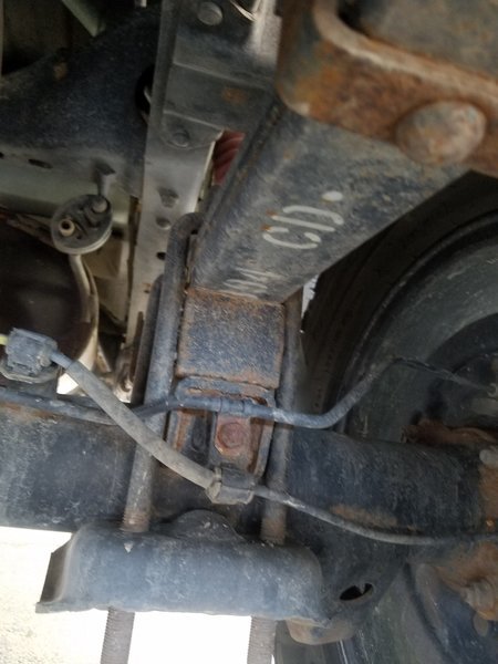

    I measure what's there and it's 2 inches. Okay remember im new at this but heres a Dumb question but do the trds come stock with something under the leaf springs?
  10. Dec 14, 2016 at 7:49 PM
    #50
    Silverspool
    Silverspool Come at me Bro!
    Jul 6, 2016
    #191387
    8,266
    Frank
    DFW
    18T4RORP 17GT350
    Anyone seen my wallet?
    Thats def a 2 inch block.. im betting you have quick lifts, actual 2 inch spacer up front, or worn leafs

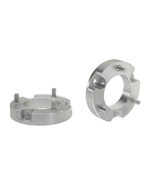

  11. Dec 14, 2016 at 7:53 PM
    #51

  12. Dec 14, 2016 at 7:56 PM

    Koitz
    Koitz Well-Known Member
    Sep 15, 2016
    #197378
    691
    2016 TRD sport 4x4 DCSB 2" lift 285/65/18 and loaded
    2" lift,18"rims, 32" tires,pro shifknob, black emblems etc
    That looks like a 2" that's for sure
    My 2016 sport doesn't have any blocks
    I don't know much about the 2012 like yours but I doubt that's stock .
    If I was you I would post this questions on a 2nd gen treat like
    "What have you done to your 2nd gen today"
    A lot of smart guys there ,I'm sure they can help you

    #53
    Koitz
    Sep 15, 2016
    #197378
    691
    I have the exact same ones
    They measure 1"
    But they'll give you a 2" lift (give it or take )
    But still Doesnt make sense ! With 2" block on the back and 2" on the front yourvtruck should sit lower on the front because the truck comes stock with the rear about 1 1/2 to 2" higher

    #55
    jshsltr
    jshsltr Well-Known Member
    Sep 3, 2012
    #86120
    1,056
    Josh
    St Louis
    Do the leaf springs go like this :(?
  16. Dec 14, 2016 at 8:04 PM
    #56
    Tjoe12
    Tjoe12 [OP] Active Member
    Sep 21, 2016
    #197924
    34
    2012 taco trd off road 4x4
    They look loaded down. No cracks or anything like that
