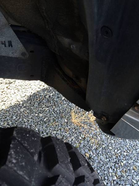

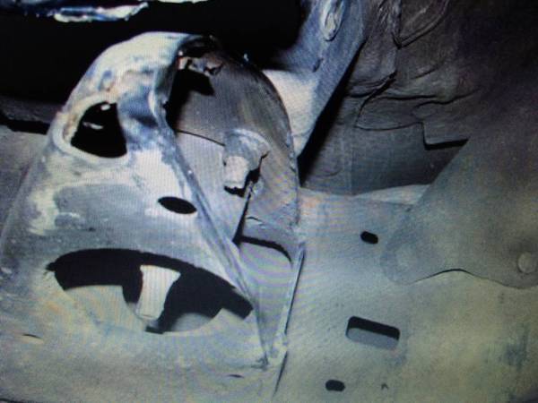

  17. Mar 30, 2015 at 3:51 PM
    #17
    2012SilverSport
    2012SilverSport Well-Known Member
    Apr 16, 2012
    #77067
    594
    Guam
    2012 Silver TRD Sport Double Cab
    CS Jumpers LED's throughout the cab and marker/DTRL's weather techs/seat covers. Head unit Pioneer AVHX5500BHS, Speakers, Front, Polk Audio DXi 6500 component, rear Polk Audio DXi 650s Subwoofer Sound Ordinance B-8PS, Amplifier Alpine KTP 445U. Front ICON extended travel 2.5 remote resi, Camburg UCA's. Rear ICON 2.0 remote res rear. Wheelers 3 leaf HD progressive AAL,
    looks like this,
    During
    After

    Maybe redundant info, but just so your clear, you only need to do the driver's side bushing replacement to fix the vibration (assuming you verified that is the issue). It sounds like 2012SilverSport was tackling two projects on the same day.

  19. Mar 30, 2015 at 5:38 PM
    #19
    Rockdwg
    Rockdwg [OP] Well-Known Member
    Jan 19, 2014
    #121036
    69
    Rapid City, South Dakota
    2008 Tacoma DCSB trd off road
    cool thanks
  20. Mar 30, 2015 at 6:40 PM
    #20
    2012SilverSport
    Apr 16, 2012
    #77067
    594
    Guam
    Sorry if I mislead. Yes the CMC is entirely separate of the ECGS bushing. since I had my front end torn down on the drivers side it made it easier to get a good approach to the cab mount. As was mentioned before in this thread put it in 4wd if the vibes go away it is most likely that you need the ECGS bushing.
