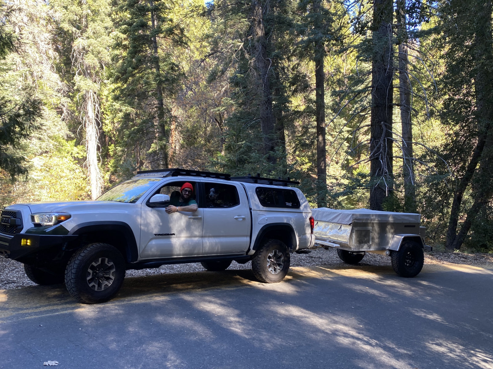

    I tow a few different loads(waverunner/boat/camping trailer/car hauler) and do a bit of offroading here in SoCal. I ultimately went with King 2.5 w/ adjusters(best dampening performance/longevity/no "shock wane" from overheating), run a AAL and Firestone ride-rite bags(run 15-45 PSI depending on hitch weight), and some UCAs. My taco is heavy though, full armor, campershell, racks. I regeared to 5.29s and have KDMAXX tune on 265s(E load for the sharp desert rocks in DV/Anza), the gearing/tune makes the truck perform how it should from factory. All in all, i go by the old addage "buy once, cry once" as the aftermarket for these trucks is not the cheapest.
    I aimed for a "stock" looking capable truck.
    There are many options out there, with numerous forum posts on the efficiency of each "kit" or shock setup(pages on pages).
    There is nothing wrong with the Bilstein 5100's, they are entry level though and provide minimal improvement from stock(check shock shaft size), i would find ones with external reservoirs as they assist with heat dissipation(heat kills shocks rebound ability). Spacers are quick and cheap "lifts", but remember that is all they provide..."lift" without any gained function(actually limited functionality due to adjusted geometry w/ spacer lift).
