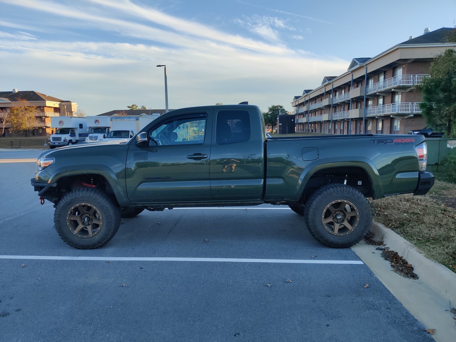

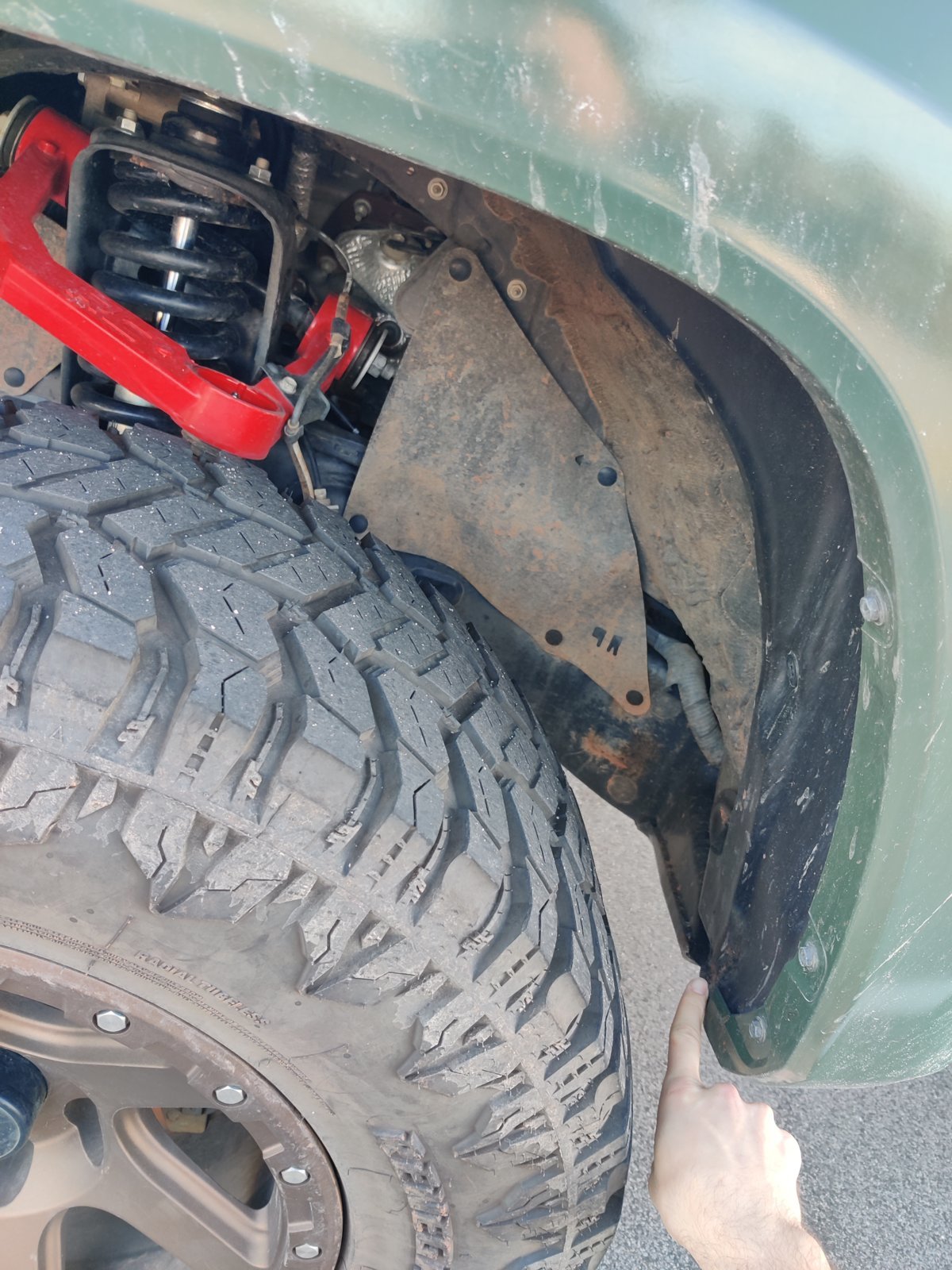

    Hello, I have a Toyota Tacoma TRD Sport with a 3in suspension lift. High clearance C4 fabrications steel bumper. The back end of my truck is higher than my front about an inch. I would like to raise the front so my truck looks level and so I don't have to trim my finders where the cab is. I have 285/70r 17 tires. When I turn my tires and go over steep inclines my tires rub on the plastic. Any way I can do this?

    Rake is engineered in to all trucks.
    You'll have better truck function if you leave it.
    Rather than raise the front more, why not lower the rear about 1/2" ? That will make it about level.

    This is what my truck looks like. I'd like to avoid getting different suspension parts if possible. Adding the steel bumper did bring the front down 1/2 to 3/4in. I have the rough country 3.5 in lift.

    What suspension lift was put on it? Are the UCA's and LCA's still stock? Have you done a CMC or trimmed the fender plastic at all? Running wheel spacers? Offset of those aftermarket rims? Need a lot more info here to determine what's causing the rub.
    Also you may not want to drop the rear. If you ever put a load in your bed you'll end up with a goofy Carolina squat.
    Get some close ups of the actual suspension components if you can.
    Edit: I see you edited your 2nd post to include that you have a RC lift. There are many tiers of rough country lifts ranging from hot garbage to okay-ish. Still need pics.

    you can lift front an inch but unless you plan to never hit any kind of bump or incline its still gona rub when tire moves upward. just trim the plastic like everybody else does. in a spot where is virtually un noticeable. i cut the bottom of flare then used a heat gun to mould back the inner liner. also being a lighter access cab your probably now sitting at a optimal height up front with that bumper so id personally not raise anymore. pull a leaf out of the rear pack if you have the kit that came with them. if blocks then get a smaller one

    Lower the rear, adding more suspension lift to the front won't solve your rubbing issues. Start cutting
