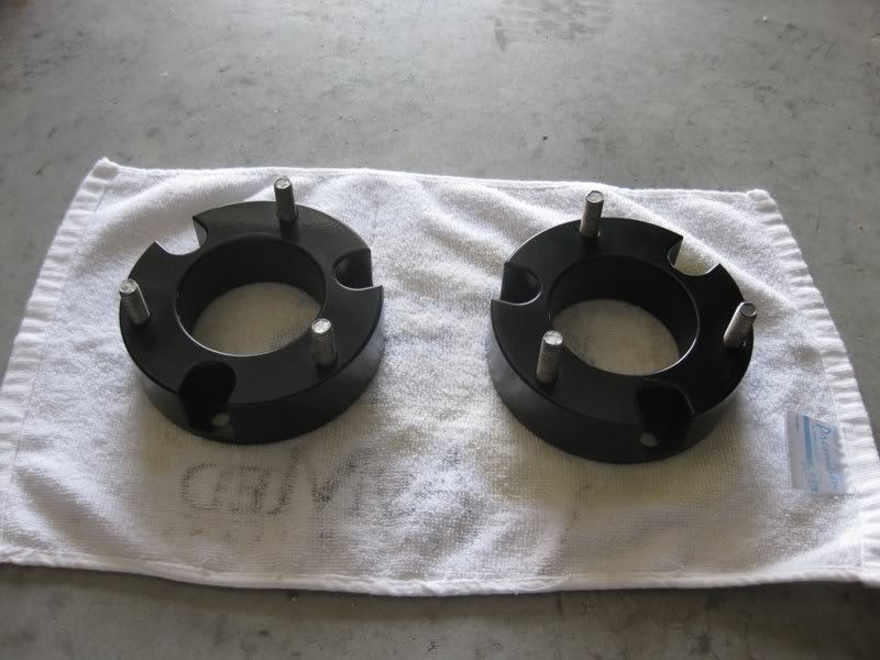

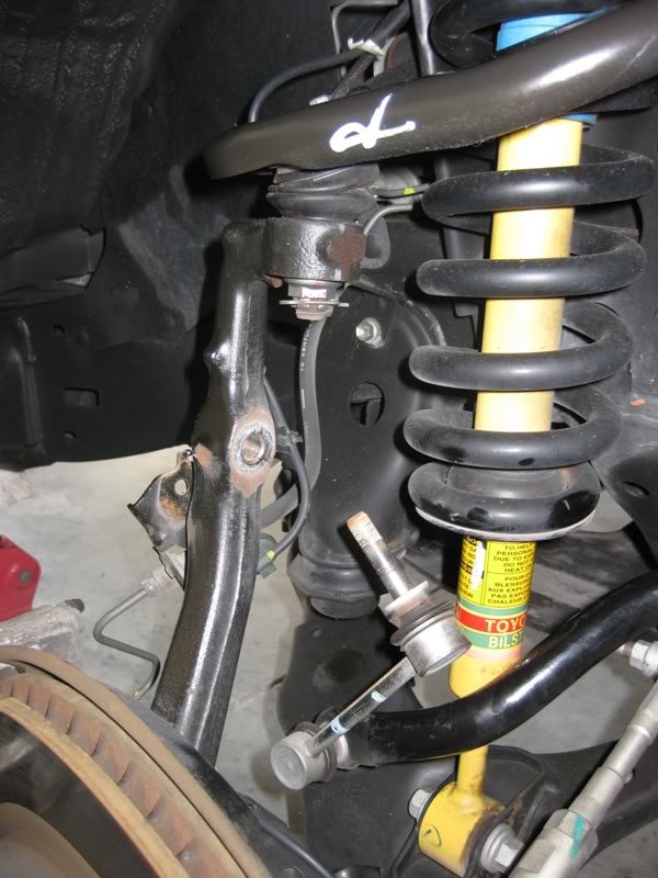

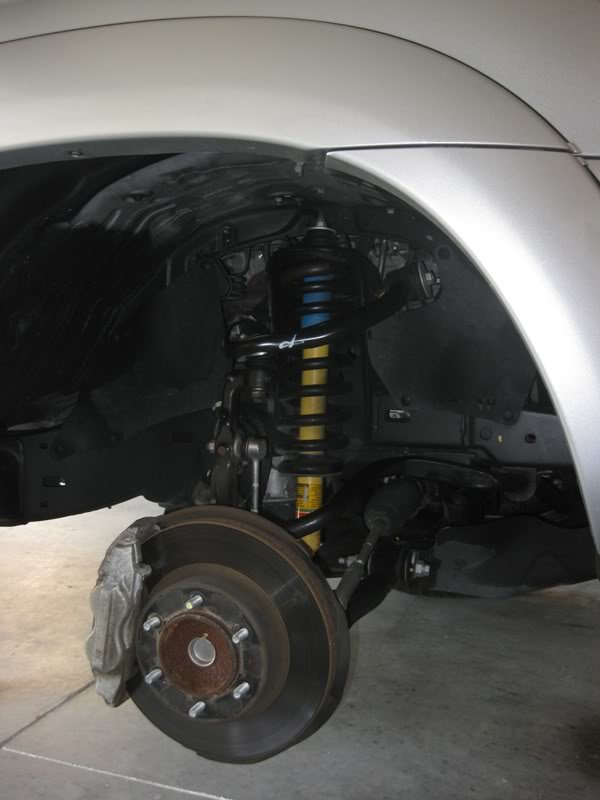

    After looking around I found an aluminum spacer kit that would correct the 1.5" difference I had between front and rear. Here are a few images of the process...
    I painted the raw aluminum spacers black with engine paint (I don't like seeing the shiny metal spacer).
    The front end is sitting a little higher right now but from what is in the paperwork this is normal prior to having it settle completely.
    Overall this was a 3hr job with plenty of breaks in between :D

    I'm thinking a top-plate spacer won't settle at all. All you did was make the shock/spring assembly longer. There's nothing to "break in" so to speak.

    like KPT said, there is no settle. I had the Pro-Comp leveling kit on mine prior to the
    5100's, no settling because there is nothing to settle, you are just making the ass'y longer. Makes the truck look better tho! I like it!!

    No, because it lifts the truck the same amount on each side.
    To correct the taco lean you need adjustable coilovers or a single 1/4" top plate spacer.

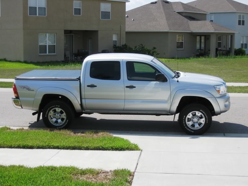

    Hmmm, well then I feel I have been mislead on this kit! I was off by 1.5" from back to front and now after final assembly the back is at 22" from center to fender and the front is now 23"... Numbers prior were 20.5 and 22...
    What gives?

    Because of how the suspension is set up, if the spacer is 1.5" thick, you will get around 3" of lift.
    Think of it like a level or a see saw. Increasing the height of the fulcrum in the center by some amount will lift the end of the see saw a lot more.
    Did what I just said make any sense at all? I wish I could draw it....hard to describe in words

    That looks more than 1.5" of lift. The spacer may be 1.5" thick but it kinda looks like 3" of lift

    Here is the description...
    Toyota Tacoma 1.5" Leveling Kit
    2005-2010 4x4 & 4x2 Models (6-LUG)
    This leveling kit offers you an affordable, yet durable and reliable, method of leveling out your Tacoma. The truck comes from the factory ~1.5" higher in the back than in the front. This easy to install kit will "raise" the front end of the truck by ~1.5", allowing for extra clearance, a overall better look to the truck and the opportunity to but those tires you want on there, without adding the whole body lift kit.
    • Precision CNC machined, down to less than 1/1000 of an inch, out of solid T-6061 aluminum, not multiple pieces welded together and powdercoated to hide flaws, like some other brands.
    • Studs are rated at 58,000 psi !!! Not cheap, welded in Home Depot/Lowe's bolts like some sellers.
    • Comes with all the hardware and detailed instructions needed for easy installation. No spring compressor required for install.
    • IN STOCK, ready to ship by a fellow Tacoma owner.
    • Super fast (99.9% of the time same day) shipping at below cost prices.
    • Excellent customer service, event after the sale, unlike some sellers.
    I met with the guy when I purchased it (local seller / machinist) and he is also on the forums (not sure of his user name but I shot him an email).

    Hmm I would measure it when you can to see how thick it is....For around 1.5" of lift, you would want the spacer to be ~0.75 inches thick (see my post above)

    Well the spacer is much greater than .75"
    Anyone wanna tell me what I need to do next since I just got a 2.5" lift kit? (what wheel adjustments need to be made now?????)
