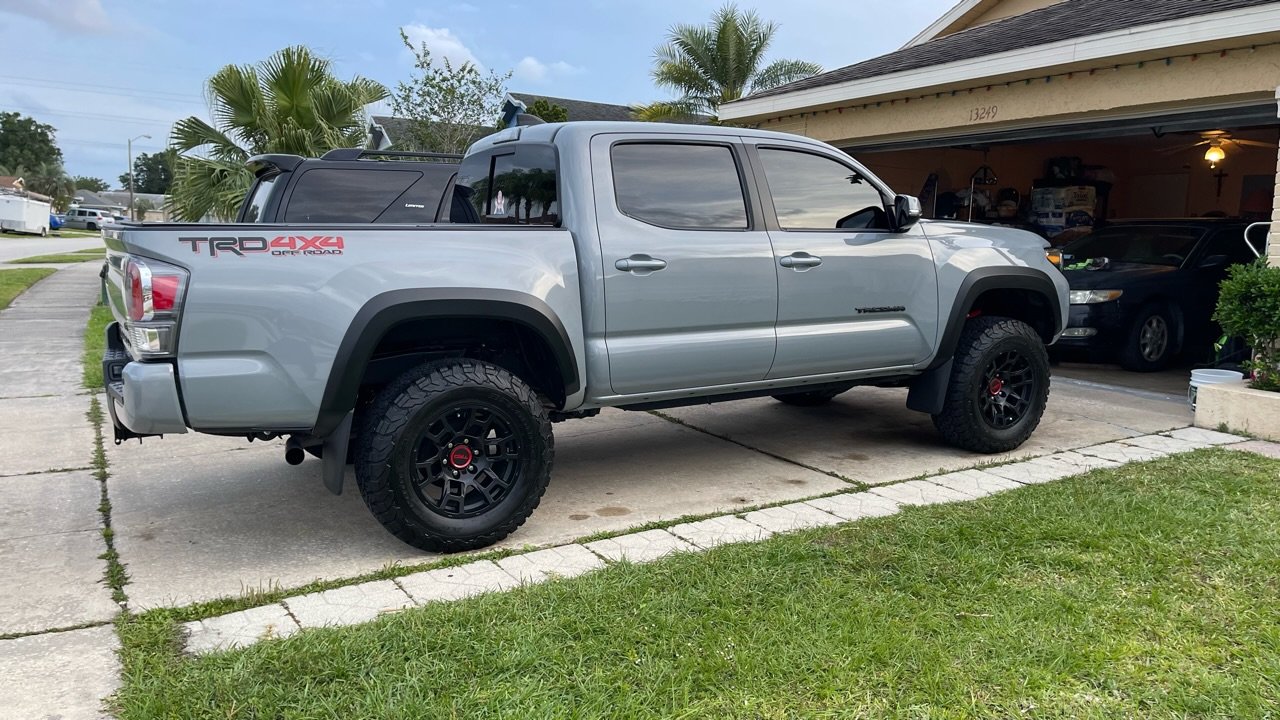

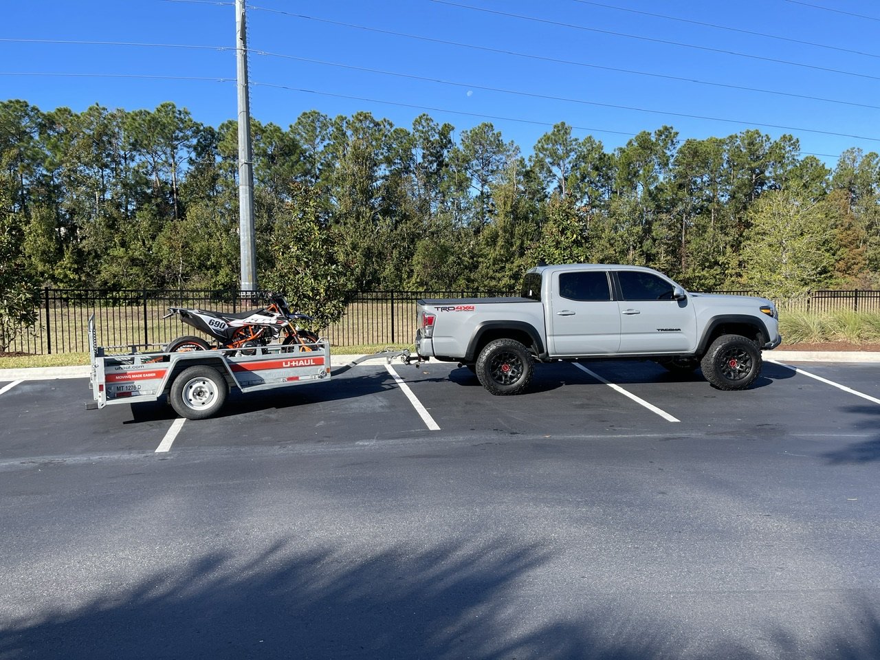

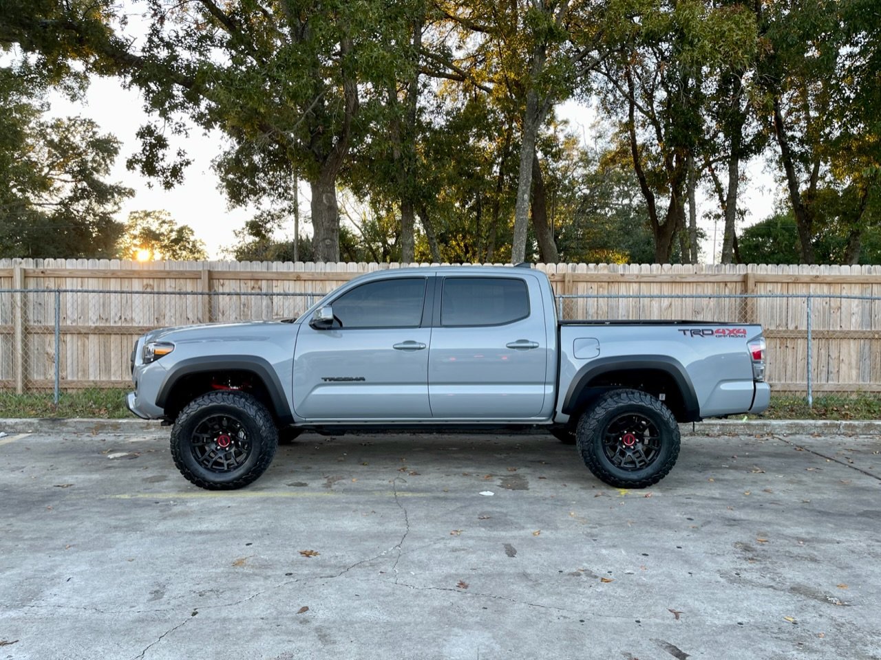

    Not a trd pro. But hope this helps. 1.5 inch lift all around with 265/70/17 pretty much same tire size as 265/75/16

    Looks clean! do you happen to have any photos from other angles?

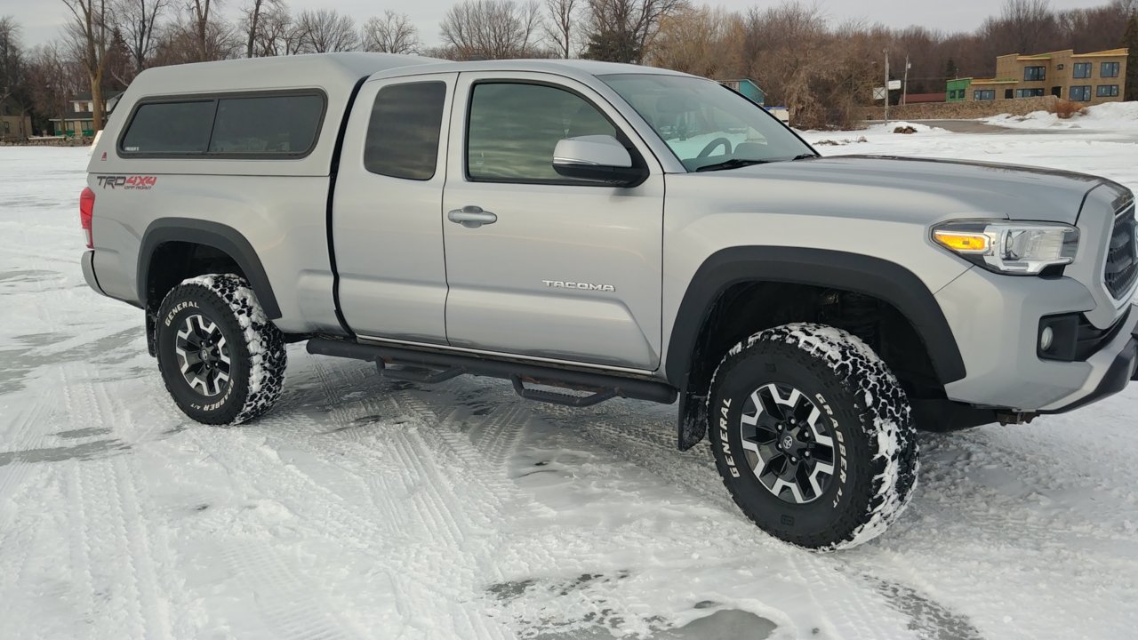

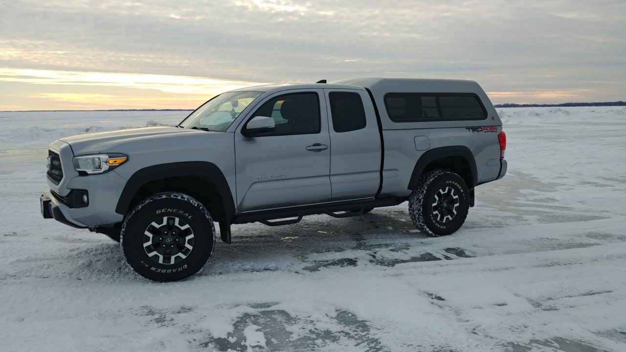

    Small lift, slightly oversized tires, well...
    Again, not a Pro but should give you an idea:
    I know, shyte lighting. This was from the day the 265's were mounted. I have spacer lifts on all 4 corners. I think the fronts are 1.25" and the rears are 1.5". Truck sits almost dead level.

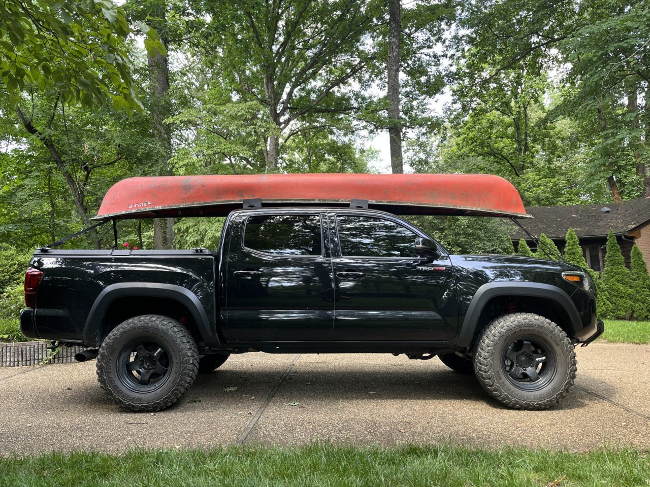

    Also not a pro, but pro suspension with eibach springs and stock tires. I have 265/75/16s on order, should be here at the end of the month.

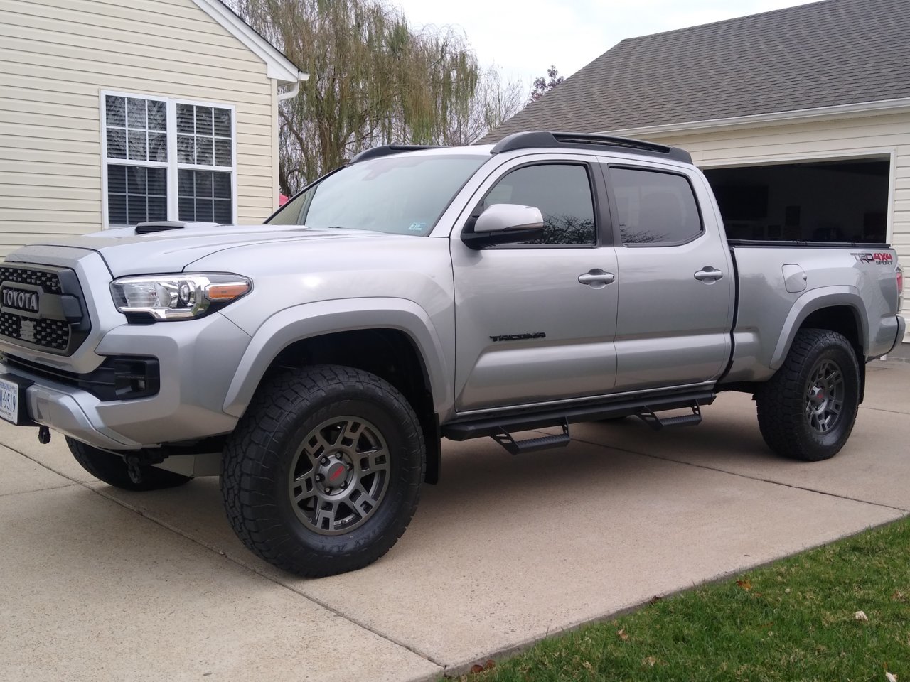

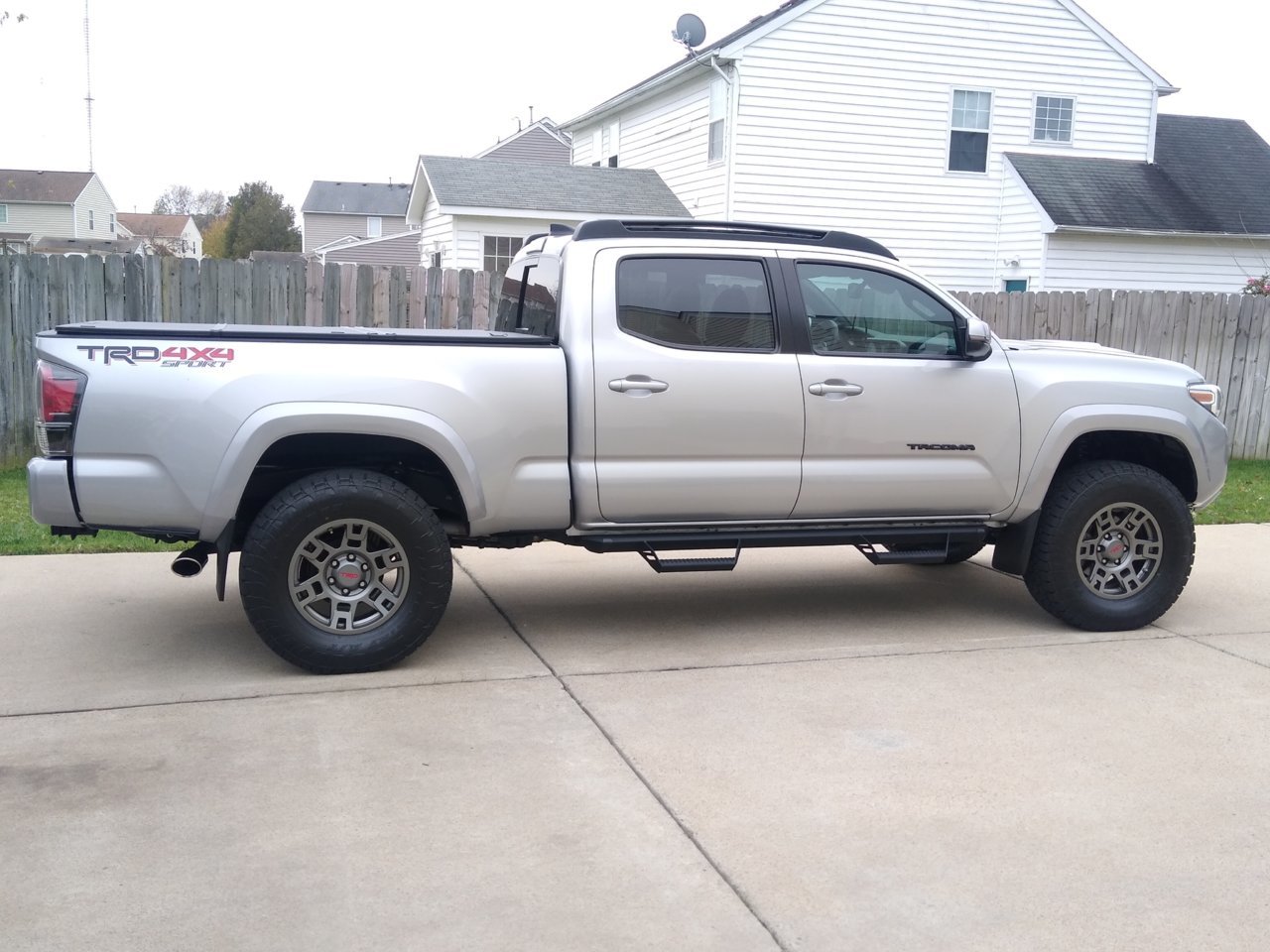

    IMG_20221115_125747460.jpg IMG_20221115_125953019.jpg Here is my now leveled TRD sport up from the 4th to the 5th perch 5100s Bilstein gave me about 2 inchs up front and a one inch rear block, 1/4 shim for the lean, Sumo bump stops with Toyo At3s 285/70/17s on some 4runner SEMA wheels. No rub, factory mud guards and a damn good alignment. I have been beside a pro and it sits a little bit higher, very noticable.

    Truck looks great brother hope all is well

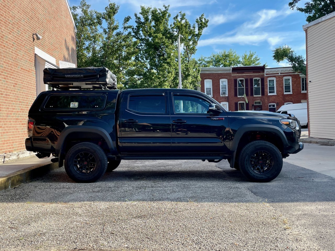

    Eibach TRD Pro Lift Springs up front, Dobinson's 600lb rear leafs, Timbren Rear Bump Stops.
