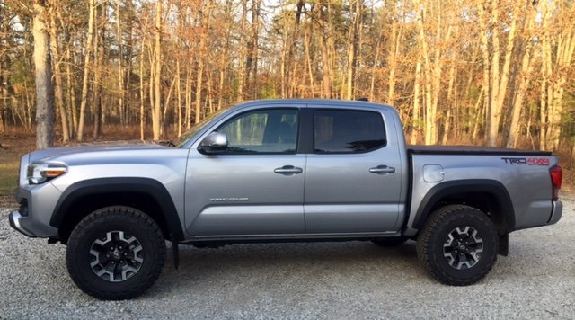

    I have 5100's set at .85. My truck sits almost perfectly level. Ride was improved not as spongy and yes this setting raised the front! Love the ride on and off road. Does the nose look lower? Valving incorrect?? Started at 1.75 nose was high moved to .85. Happy with the outcome...
