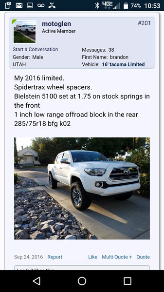

    billies set at 1.75 front and 1 inch block in the rear. 285/65r18 nittos
    Sorry guys I fixed my typo 285/65r18 instead of 285/75r18
    Ya i mistyped it. I fixed it.
    Ahh. It will be very close.
    I would just bump up to the next setting. I love how mine rides. 1 inch block in the rear. Sits a tiny bit taller in the rear.

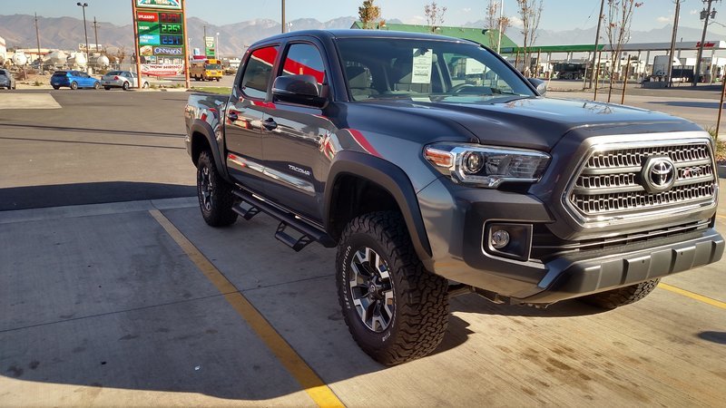

    Just added 5100's all the way around with stock springs. 4 Wheel Parts did the install and got everything perfectly level and re-aligned. I really like the way it rides, feels factory but a little tighter/firmer. IMG_20161106_122834827_HDR.jpg IMG_20161109_082643131_HDR.jpg
  11. Nov 9, 2016 at 6:40 PM
    #211
    OhioTaco68
    OhioTaco68 John 3:16
    Apr 17, 2016
    #184564
    2,230
    Central Ohio
    16' Tacoma SR5 4x4 access cab Silver Sky Metallic
    AVS in channel window deflectors Predator steps Tinted front windows De-badged all chrome emblems Matte black tailgate lettering Matte black door badges Silver door sill lettering Weathertech mud guards Tacoma bed mat Interior LED lighting Lamin-X yellow fogs Hyper yellow DRL LED 3rd brake light bulbs CLEARZ 3rd brake light lens LED back up lights Access LITERIDER tonneau cover Console cover w/Toyota logo Hondo radio knobs NeoSupreme seat covers TRD shift knob Toyota Dark Satin Alloy wheels Toyo Open Country AT3 tires Red glovebox lettering Red vent rings/ control knobs Husky all weather mats Toyota bed mat
    What setting did you go with on the front 5100's ... looks great !
  12. Nov 9, 2016 at 7:02 PM
    #212
    G-Force
    G-Force Active Member
    Sep 11, 2016
    #197018
    44
    2016 Magnetic Gray Off-Road
    I got under there and checked; there are four grooves and they used the top setting. The way they explained it is they adjust so the truck is level and then test drive to make sure it is settled and they check it again. After all is set they do an alignment. They told me the usual adjustment on a 2016 is about 2"

    Alignment is back to spec and I think the ride has an improved feel over the factory OR shocks.
  19. Nov 9, 2016 at 11:40 PM
    #219
    G-Force
    Sep 11, 2016
    #197018
    44
    Here's another shot of the after:IMG_20161107_142501849_HDR.jpg
