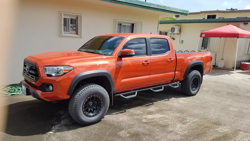

    songsong
    songsong Active Member
    Feb 20, 2017
    #211183
    31
    Guam
    2016 Tacoma Inferno DCOR
    20170225_140158.jpg Here is one with clip at the 1.5 notch

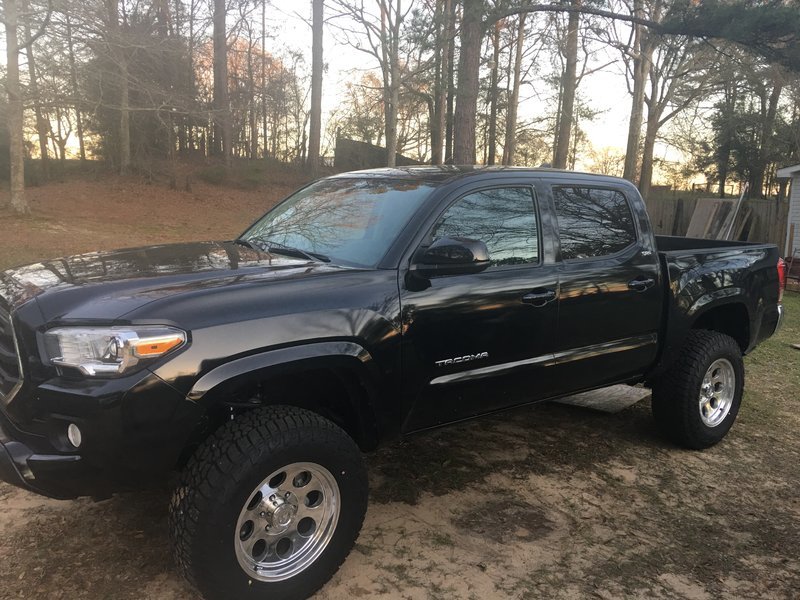

    dhughins
    dhughins Well-Known Member
    Nov 13, 2014
    #142242
    80
    Dave
    Skipperville AL
    2016 SR5 DCSB V6
    Not sure if this pic helps but here is 2nd gen 5100 at 3rd notch(1.75in)on stock springs. I also did a deavers aal 1.5in on the rear. Haven't drove it since I did rear this afternoon. I drove it this morning after I had only done the front and it rode the same as before. IMG_0816.jpg

    dhughins
    Nov 13, 2014
    #142242
    80
    Dave
    Skipperville AL
    2016 SR5 DCSB V6
    I have Falken Wildpeak at3 265/70r17. They look more aggressive in person then in these pictures.
