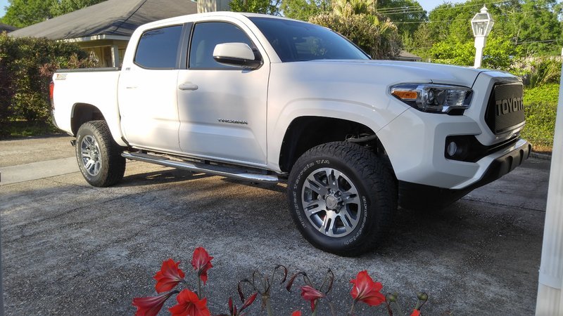

    Got my lift installed today went with 1.55" on front Bilsteins & 1" block in back with Bilsteins. Lifted about 1 5/8" in front & 1 1/8" in back. Got about 5/8" take. Not much lift but what I was looking to do. Did you get your truck today?

    Here she is

    Where did you find a 1/2'' block? All I can find are 1''. I set my billies at the third notch (1.1'') and now it sits dead even. I only want the rear lifted about 1/2''

    I got about 1/2" to 5/8" from front to back. Just to let you know.

    How did the alignment come out with the 1.55 setting? 3rd gen specific 5100s obviously?
