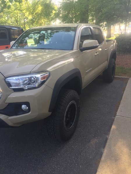

    265/70/17's with 5100's set at top notch and 1 inch block in rear.IMG_3010.jpg

    Did you put 5100's in the rear, or are you still running stock shocks?

    Yup 5100's in rear and 1"block

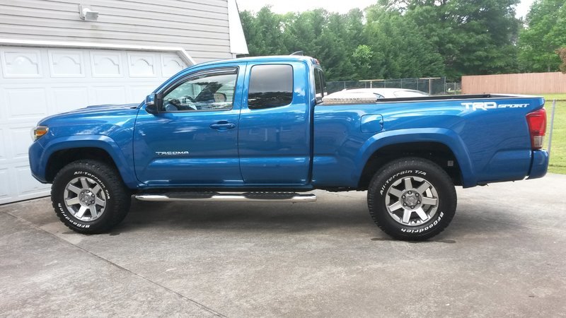

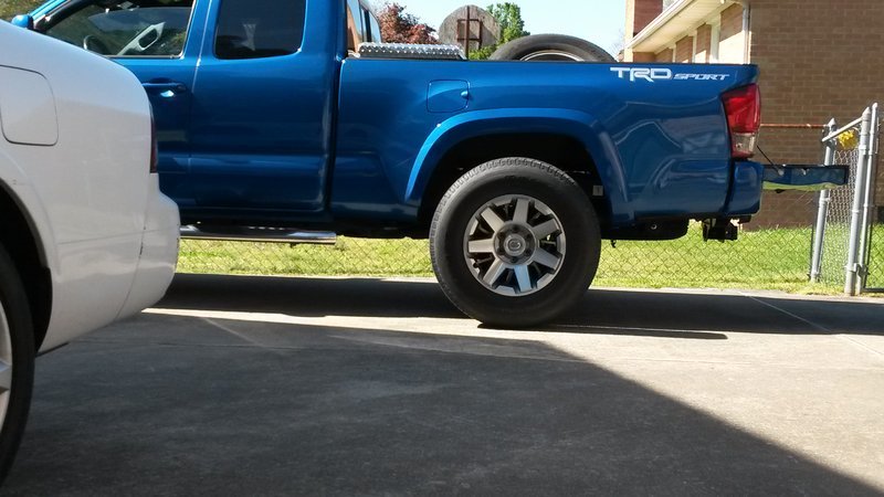

    I wanted to level mine but I am on 265/70/17 stock with tons of clearance on my 2 wheel drive. Really wanted to go to 275/65/17 on my 17 x 8 but BFG only comes in E rated that size. Probably going to go with stock suspension. I am probably putting 265/70/17 C rated KO2's on my spare set of FJ wheels just for a different look for the summer.

    Does the rear feel as good as it did when it was stock?
    I put 5100's on the front, but I only went 2nd clip from the top. Front rides great.
    I put a 1" block in the rear, but kept stock shocks. I didn't think only 1" would affect the ride, but it isn't smooth like it was. Feels a little rougher, like the SR5 and Sport I test drove before I bought the OR. I guess I need to go ahead and replace the rear stockers with 5100's.

    i would recommend if u got the cash. Feels alot smoother.

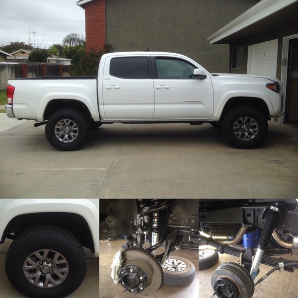

    @Dean724 Truck came out perfect! Thanks for posting your setup, really helped me decide on what setting to use!

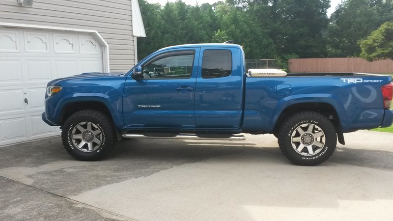

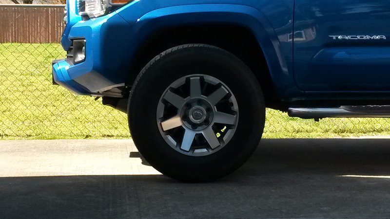

    Going to order front 5100's this week. Just going with .65 setting to level. Only possible rear change will be 5100's for ride consistency and towing stability. Looking at 24'-25' light travel trailers in the near future. Riding on 265/70/17C BFG's and could use a hair more clearance up front. The general consensus is the 5100's are more stable and comfortable than the stock shocks. Not a whole lot of rake on my stock 2 wheel drive suspension so .65 should be correct. Best deal I have seen on the 3rd gen shocks is from Race Consulting Agency at $201 a pair delivered.

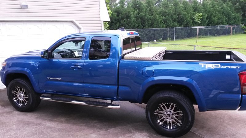

    Exactly level at 0.65 setting

    As my post shows (just before yours) mine is dead level at 0.65. No sagging after 5-6 weeks and running 265/70/17's.
