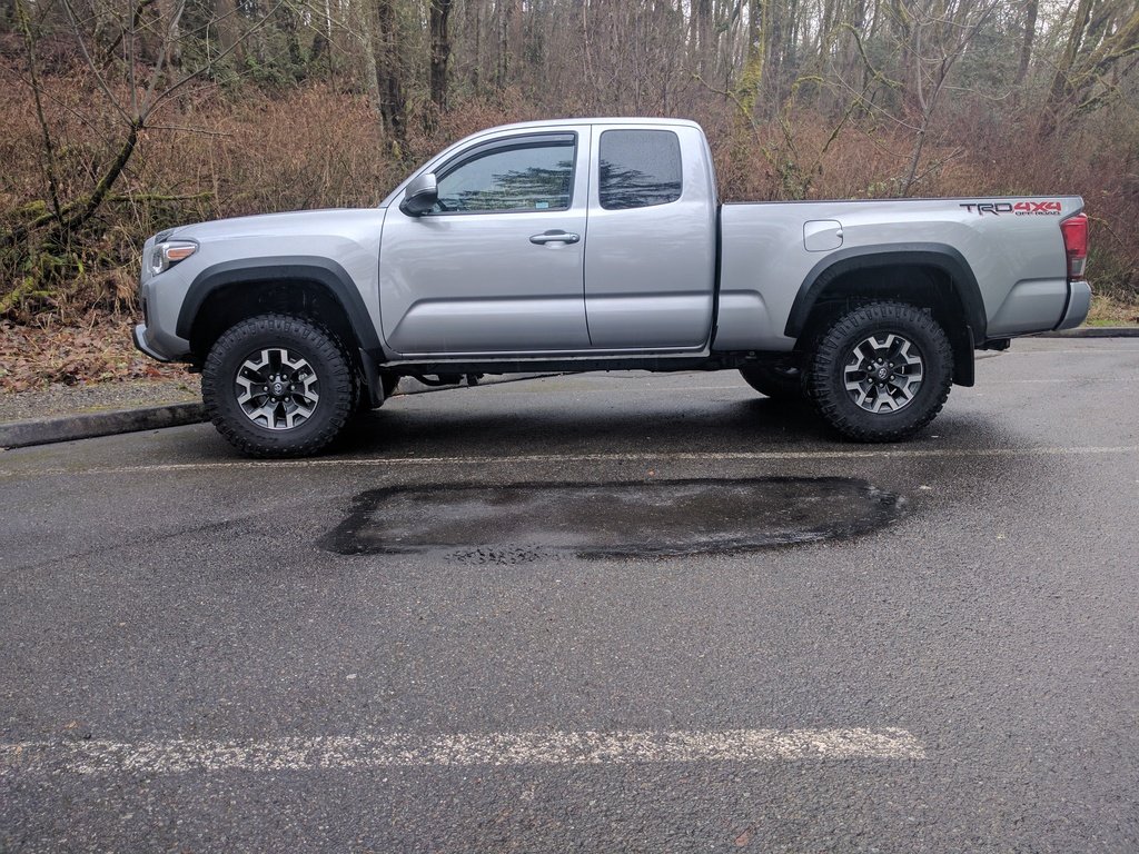

  7. Aug 22, 2017 at 2:29 PM
    #347
    TRDOBSESSED
    TRDOBSESSED Well-Known Member
    Oct 7, 2016
    #199198
    542
    Blair
    Puyallup, Wa.
    2017 TRD ORAC
    OvTuned
    4th highest setting...still using the stock coils ....be sure to post up some pics !
