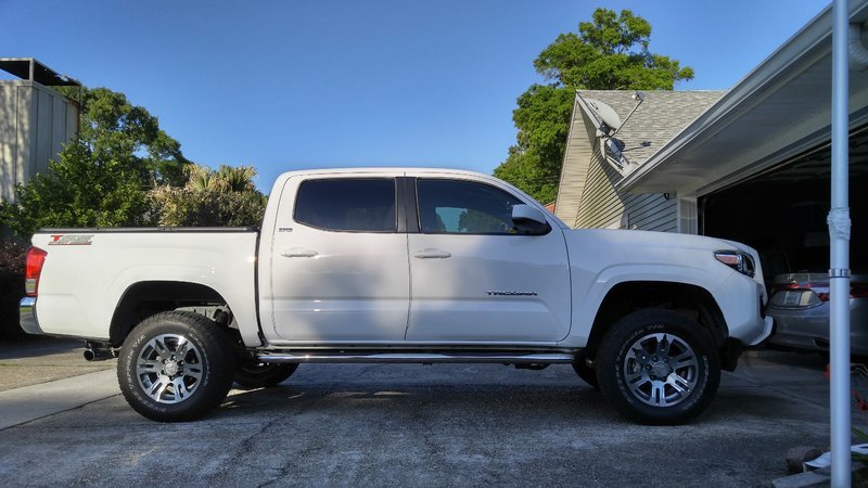

    A7184B58-918F-41B3-A894-C1F1B185CA3F.jpg A5FD62B2-F3C8-4B14-B30C-1E98E1674C57.jpg 333DE137-FCB1-40D3-8854-D562F77A6474.jpg Bilstein 5100 all around, set at 1.1 leveled perfect. SR5 Coils

    mine is at 1.1, nothing in the rear. I had a single deaver, but i had some vibes that i couldnt get to go away. I pulled it today. Truck sits dead level, but I'd prefer alittle rake. Im sure if I popped the cap off I would gain a 1/2" back, since the springs are so soft.IMG_4021.jpg
    MJSandy and Chrisperez305 like this.

    I ordered 1/2inch block from Toytec , that’ll be having installed next week. To put a little rake back. I’m sure those will work for you

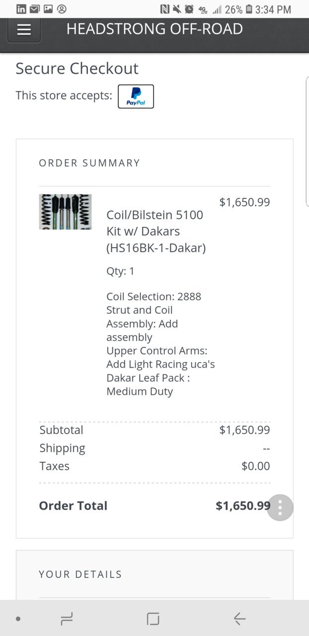

    Hi,
    I was looking to get the following setup and set it at .85
    Would this give me a full 3 or close to? Attached is what I was going with. Decided on 888 since seemed to get a little more height out of it.
