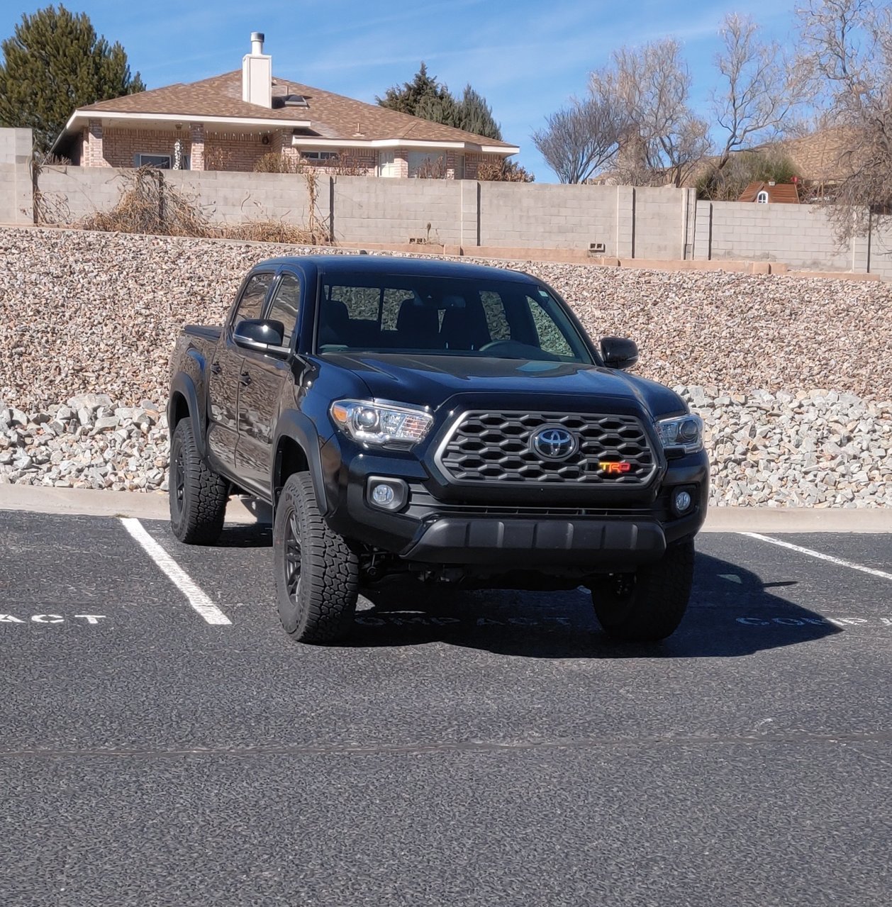

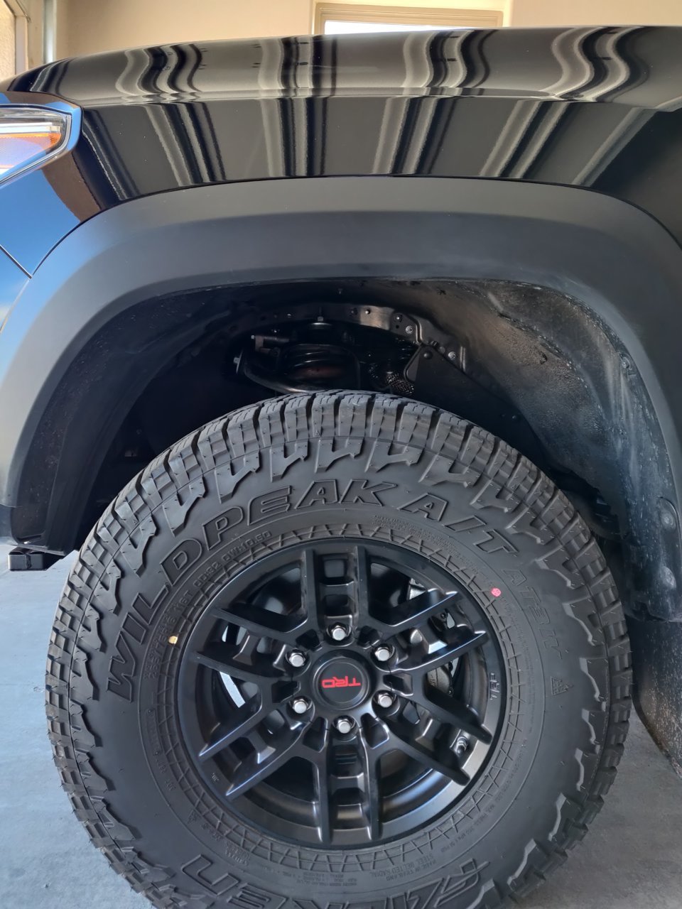

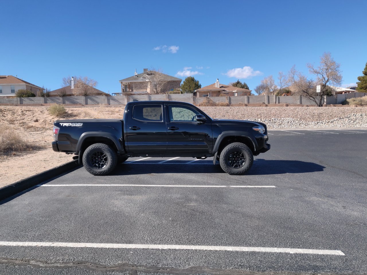

  19. Oct 4, 2020 at 6:32 AM
    #399
    mmblue4x
    mmblue4x Well-Known Member
    Jun 25, 2020
    #332548
    105
    '19 TRDOR

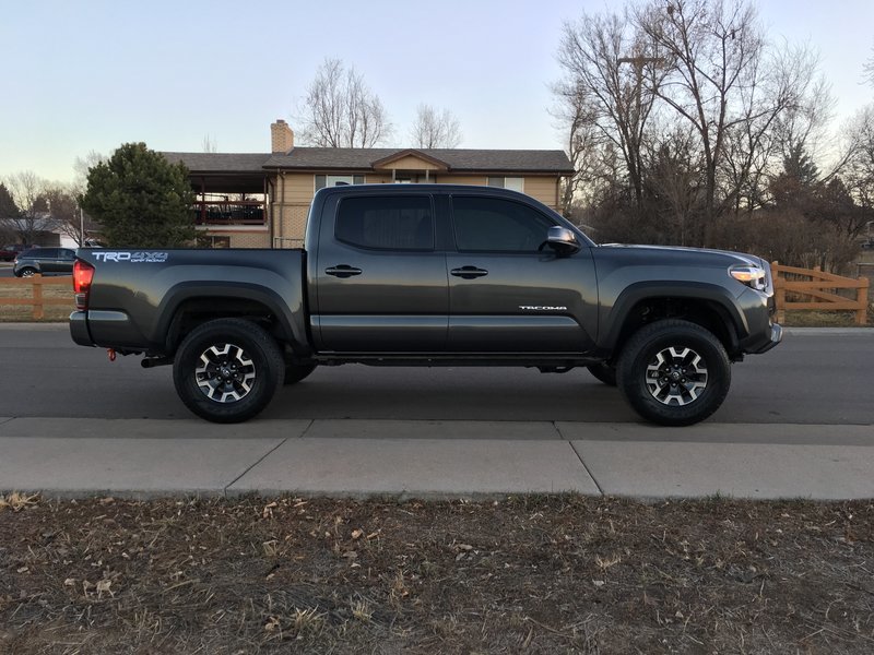

    I installed the 5100s on the front last week so I figured I'd add to the experience database. New 265/75/16 SL Goodyear Ultraterrains this week. I used the same approach I did when I changed the wheel bearings on my 09 Tacoma. Removed the skid, disconnected sway bar mounts, disconnected sway bar/brake line bracket/anti-lock bracket/upper ball joint from spindle. Then I just pried the UCA up, lowered the spindle/LCA and the shocks come right out.
    Used a Shankly spring compressor set. Felt very stable. Worth the $60. That was the lowest quote I got from local shops.
    Driver's side has red/green coil. Passenger side has red/blue coil. Set at 1.1". Got about 1" of lift after driving for a week. Toe/caster on left was out a bit, but after a toe adjustment after tire installation all settings are green. Pics are deceiving as I have about 300lbs in the back. I have about 0.500 inch rake now.
    No rub, no vibrations, so I am happy with the changes. Will likely install the 5100s on the back soon, but I doubt I'll notice a difference.
    71tattooguy likes this.

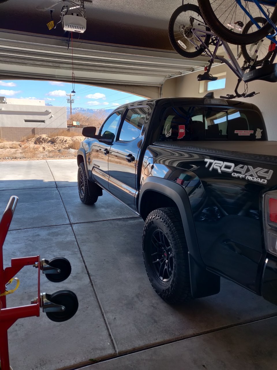

  20. Jan 30, 2021 at 2:20 PM
    #400
    CCinABQ
    CCinABQ Active Member
    Oct 28, 2020
    #345168
    34
    Carl
    2021 TRD OR
    Alright fellas. Just did the install this am. B8 5100s all around. I initially went with position 3... But I gained more than 1.1. the front was .15 inches higher than the rear. So I took it all apart and went to position 2. Now the rear is .225 inches higher than the front. I wanted a little rake as i didnt want it to look higher in the front. Here is a great link on how to do the front end without a spring compressor. worked like a charm!
    notes: OE coils, 265/75r16 tires, 5/8 tank of gas (weight).
    Bonus note: Since i swapped out the struts with the method in the youtube video... None of the camber, caster, or toe changed from their factory set positions. However, still need to get an alignment as the camber is more positive due to the lengthening of the strut. The truck still drives straight as an arrow. Getting an alignment on Monday.
    Impressions: A little more firm of a ride, but in a good way. Less body roll in the turns.. and the rear end doesn't bounce around anymore when i go over bumps.
    cheers!
    https://youtu.be/jr0v63Q7CQs
