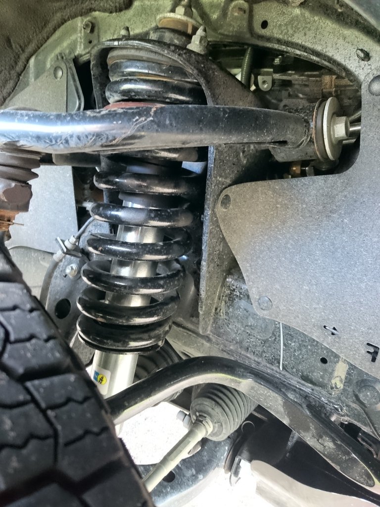

    Bilstein 5100s at .85" lift for the front. The rear is still stock. I will get the alignment in the near future. As far as the ride goes, it seems smoother than o.e.m. Bilsteins.
    IMG_20160715_164535_zpsyty97nlc_4e972ed811f732103c0c4911c429ce4a0b2e513e.jpg IMG_20160715_164554_zpsj7e8as4p_7c44a9a7f6e0d08f281c76d14bf8fa452b07829c.jpg IMG_20160713_111545_zpsdjx2ggf7_4a1799a402664096a9216a7d831c8e8074f73da9.jpg
    Rb1 and 0311K1LL like this.

    Looks great, I wouldn't hold off long without the alignment. By the way, leave the rear stock as far as shocks go. The 4600 bilstiens you have stock are the same valving as the 5100s.
