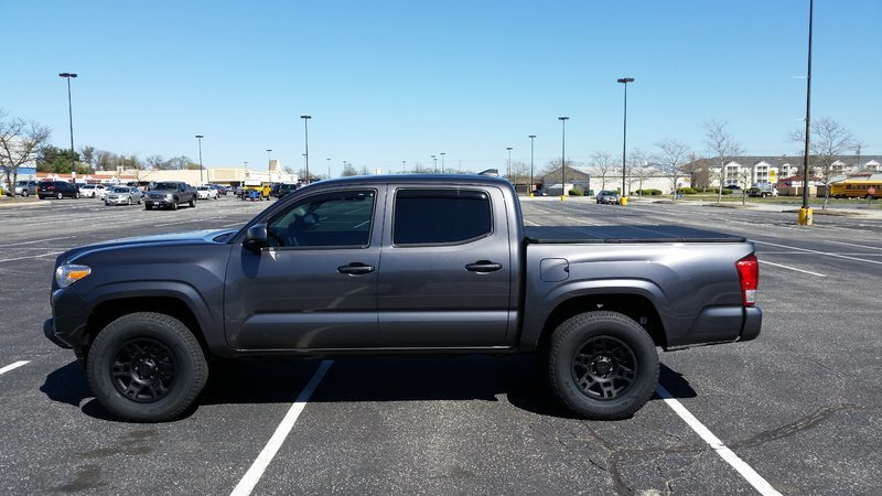

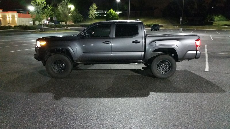

  13. Jul 25, 2016 at 12:06 PM
    #133
    bblake00
    bblake00 Well-Known Member
    May 29, 2008
    #6965
    379
    AA County, MD
    2016 Poverty Model (SR) DCSB V6 4x4
    5100's @ 0 with OME 885's and deaver ALL from Toytec.
    ETA: Spacers for the lean front and back on the driver side.

  14. Jul 25, 2016 at 12:09 PM
    #134
    0311K1LL
    0311K1LL The Old Breed
    Mar 31, 2016
    #182898
    654
    Curt
    Jupiter, FL
    2016 SR AC 2.7L 4X4
    OME 887 w/Bilstein 5100's, 1.5 AAL, SPC LR UCAs 285/75/r16 Toyo AT2s!
    poverty model LMAO! I have a poverty 2016 too! What tires you got going on there? Nice rig.
