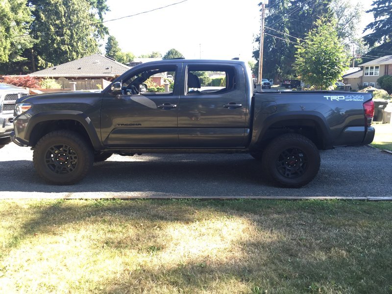

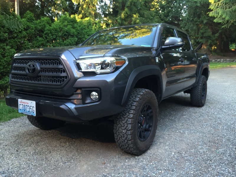

    The top pic is yeaterday after the wheeler progressive 3pack. No overload. 5100's all around with 885's set at zero. The bottom pic was with just the front done. Dead level. Sumos might give a half inch rake.image.jpg image.jpg

    Perfect, this is what I needed to see. Same truck and everything!
    Hard to tell from the bottom pic, but was it level without the wheeler 3 pack, or was the front end sitting higher than the rear, as I'd imagine it would probably be?
    Also, what's the deal with adding a progressive leaf pack to these new 2016's? I see all kind of comments that you have to drill out a rivet and grind off a stock clamp, or something to that effect? Just curious, as if I do get a leaf pack, I want to tell the installer up front that this isn't going to be straight bolt on replacement, there's going to be a little work involved.

    It was dead level without the 3pack. I don't like that look. I prefer about an inch of rake. When i put a canopy on, thats where I'll end up. Right now its about 1.5. I put the 5100's on the rear before the aal and it was stiff. Seems a bit softer now. Much more consistent with the front. As far as the clamp. Thats the worst part of the install. U remove the first clamp past the overload guide brackets in the rear. Your aal is longer on one side from the center pin. Long side goes to the rear. I drilled the pin out to remove the clamp. Your aal has a new clamp where the e-brake connects. I bought a 1/2 inch longer bolt to attach that and a second nut. You only need to do that if you remove the overload. Because the e-brake bracket attaches to the overload bracket. Don't know if that makes sense.
