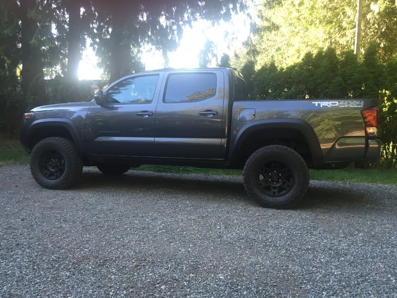

    265/70/r17 ko2. I have a gravel driveway, so my measurements are not very accurate. It seems to be consistent with what most are saying. Between 1.5 and 1.75. I had no rake before the aal. Now its about 1.75. Once i add canopy i expect 1+.

    Looks great man! Also, did you use any spacers on the front in addition to the coil setup to accommodate any slight driver side lean?

    No. If i was gonna go higher i would have. I can also add later oncethings settle. So far ive only measured 1/4 inch difference.

    Your truck looks really great!
    I've been reading on here that the TRD OR Bilsteins are valved similarly as the 5100's, but you think the rears were stiffer than stock. That is interesting. I have a TRD OR and I was thinking of just 5100's up front (on 885's) and possibly replacing the rear spring pack with something like a Wheelers 5 pack (about 1.5" rear lift from what I can tell) and then leave the stock Bilstein shocks back there.
    It may be too soon to tell, but how's the ride and handling? Have you taken it off pavement or on rough roads yet? Love to hear your feedback!

    image.jpg So, i ordered my shocks first, then the tri-pack, then the coils. I thought, what the hell, I'll throw the back shocks on for shits and giggles. I did this while waiting for my coils. It instantly felt better over rough surfaces going slowly. But on the hwy or going over railroad tracks fast. It chucked me around. It sucked on washboard. It made me really reconsider my whole lift. I reached out to the tw community, and was reasured i was on the right path. So far it feels great. I haven't been offroad yet. Just had it aligned by toyota today. I was in there for 2.5 hrs. He claimed they were having a hard time getting it right. I think it was bs. I think they were probably just behind. They did it for free. When i showed up he said "it pulls to the left" wink wink. Then the did it on warranty. Here's a pic with 170lbs of sandbags, simulating a canopy. This is exactly what I'm looking for. About 1inch of rake. Hope the helps. I think you need the 5100's for extended travel with the new pack. Thats why i went 5100's all around. The handling and ride is great. Better cornering and not too stiff.

    Give her a little time to settle and then you should have a better feel for how it all handles.

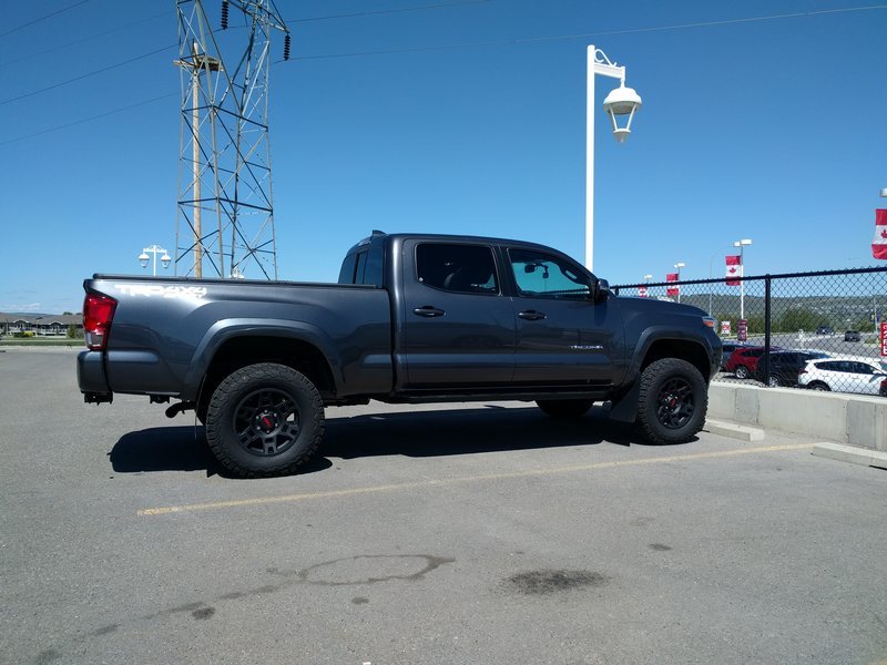

    I had this set up on my new 12' DBL Cab 4x4. Great improvement in ride over stock.
    Got a small lift in rear from 5160 s too. About 1/4 ". Not an exact comparison for you since it's last gen but I would say go for it.
