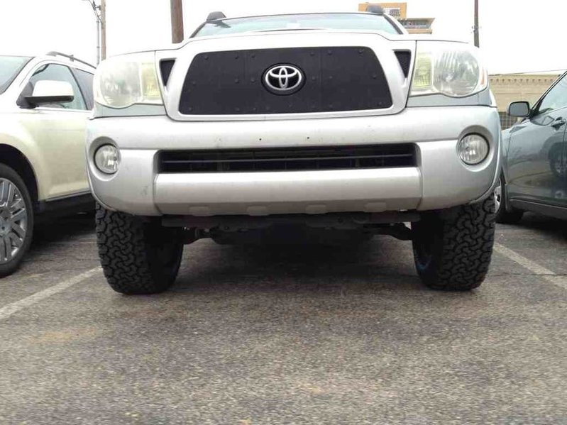

    And new tires today, alignment tomorrow!ImageUploadedByTapatalk1360691802.275654.jpg
