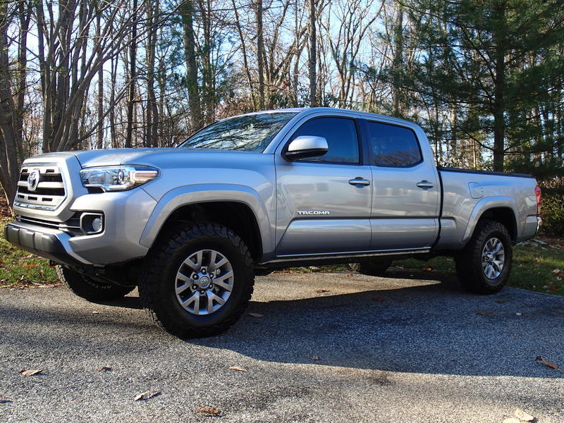

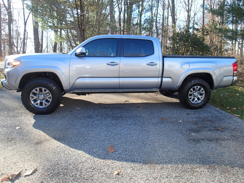

    Bilstein 5100`s are most likely the best way to level the truck. Second notch up on the shock, which is the .85 position. This will give your truck an almost perfect level stance.

    That is a beautiful truck! any rub with those large tires??? So the billstein 5100 series for the previous year will fit on the 3rd gen? Is that what is on yours?

    Yes that is the set-up on my truck. No rubbing at all.
