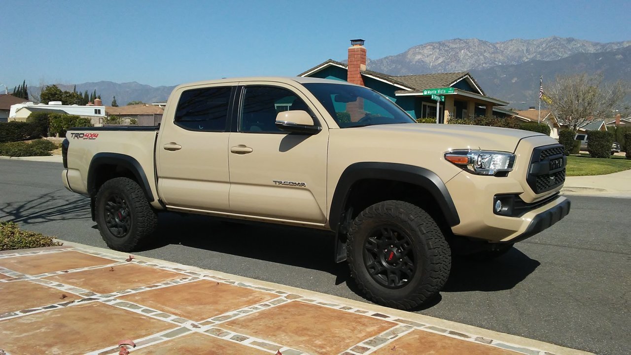

    If you like it level, then go for it. This is how my truck sits with an inch up front. When I have loaded the bed with a few hundred pounds of cement, it makes little difference. Down the road, I think I am going to give it a bit more, but will stay with a level stance. If you find you need some load carrying assistance on occasion, the air bags would be a good choice. An AAL will ride stiff When empty. You can air down the bags when empty for a softer ride.

    Good looking truck! What did you do to level it? So all in all, I could just get a set of 5100 front struts and that’s all I need for a good level?

    All I did was spacer the front. A half-inch spacer equals one inch of lift. However, This was just to get a feel for the look until I sort out what I ultimately want to do with it. It rides great and I don’t have any lift or tire related problems. I could leave it, but I have been going around with using either 6100’s or Eibach and setting the front to 1.5 and picking the back up .5. It sits on 265/70/17s. I don’t want to go bigger on tire or lift, because I don’t want the trade offs. I have had several big lift/tire vehicles and am over it. My wife has some knee problems too, which is one reason I went mid sized this time.
    I am thinking of bagging the rear for the occasional bed load and my motorcycle trailer.
    5100s would do it very simply and inexpensively. Air bags would likely sort out any trailer issues.
