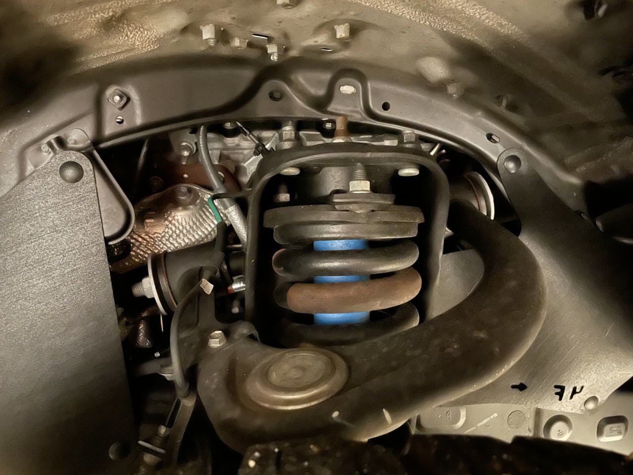

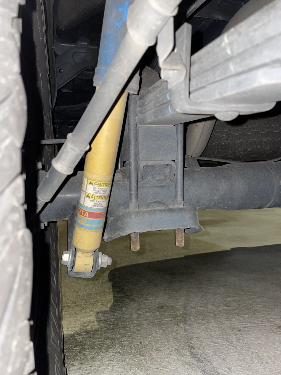

    I'm new to suspension mods and stuff, but I would like to install a Supreme Suspensions Full Leveling kit, and I have a couple of questions:
    1) Is it better for me to have both front and rear ends raised from stock by 2" or should I use another recommended setup? 2WD, ground clearance would be nice.
    2) Is there anything else that I need to do besides an alignment (regarding buying the kit)?
    Either a kit with brake relocator brackets:
    $155 Supreme Suspensions - Full Lift Kit for 1995-2004 Toyota Tacoma 2" Front Lift Strut Spacers + 2" Rear Lift Tapered Blocks + Square Bend U-Bolts + Brake Line Relocator Bracket 2WD 4WD (Black)
    https://www.amazon.com/Supreme-Suspensions-Aircraft-Spacers-Relocator/dp/B00VF412P2?th=1
    Or without them: https://supremesuspensions.com/prod...nsion-lift-kit-2wd-4wd?variant=31239204143184
    3) Can I use stock shocks and springs with this setup (budget) and will it reduce tire rubbing (265/70/R16s)?
    Any advice/recommendations are welcome and much appreciated.
    - Pretty much all trucks have a rake to it. The front is purposely lower than the back. When a load gets put on the back, it would make it even and but not squat. A leveling kit takes that away and makes it leveled which would make it squat when a load is applied. The spacers and blocks you showed will lift the truck up. The front spacers will be bigger than the back to lift and level (leveling kit). Again, any load may show the truck squatting. I believe 3inches will be a fine balance without hurting any geometry of other components. Stock tires are about 31 inches. Going to 33’s along with the leveling kit will help with clearance but it’s minute. I personally have TRD pros on 285/ 70 R17 and have no rub. Anything bigger you will have to start messaging inner fenders with heat or cutting. Hopefully not.
    alignment is a must when you start moving parts even tho they go into the same holes. When you lift your truck, you will change the look of your truck. If your running stock tires it “may” seem odd and smaller especially if your taco is next to a more proportional taco with its tire.
    nothing else needed if your just adding a leveling kit.
