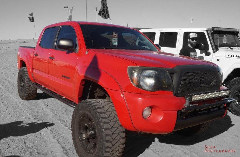

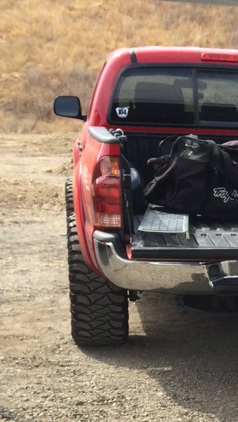

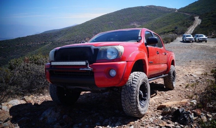

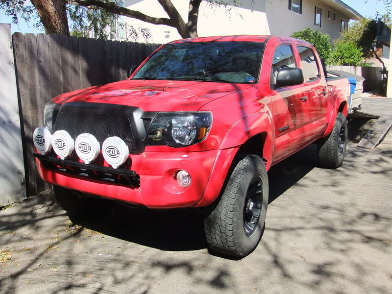

    Wide tires FTMFW
    285/70-17
    33x12.5x17
    295/70-17

    33x12.5 that's the shit I can get down with. 285 all terrains still look like cookie cutters on tacomas

    They were fun while they lasted.
