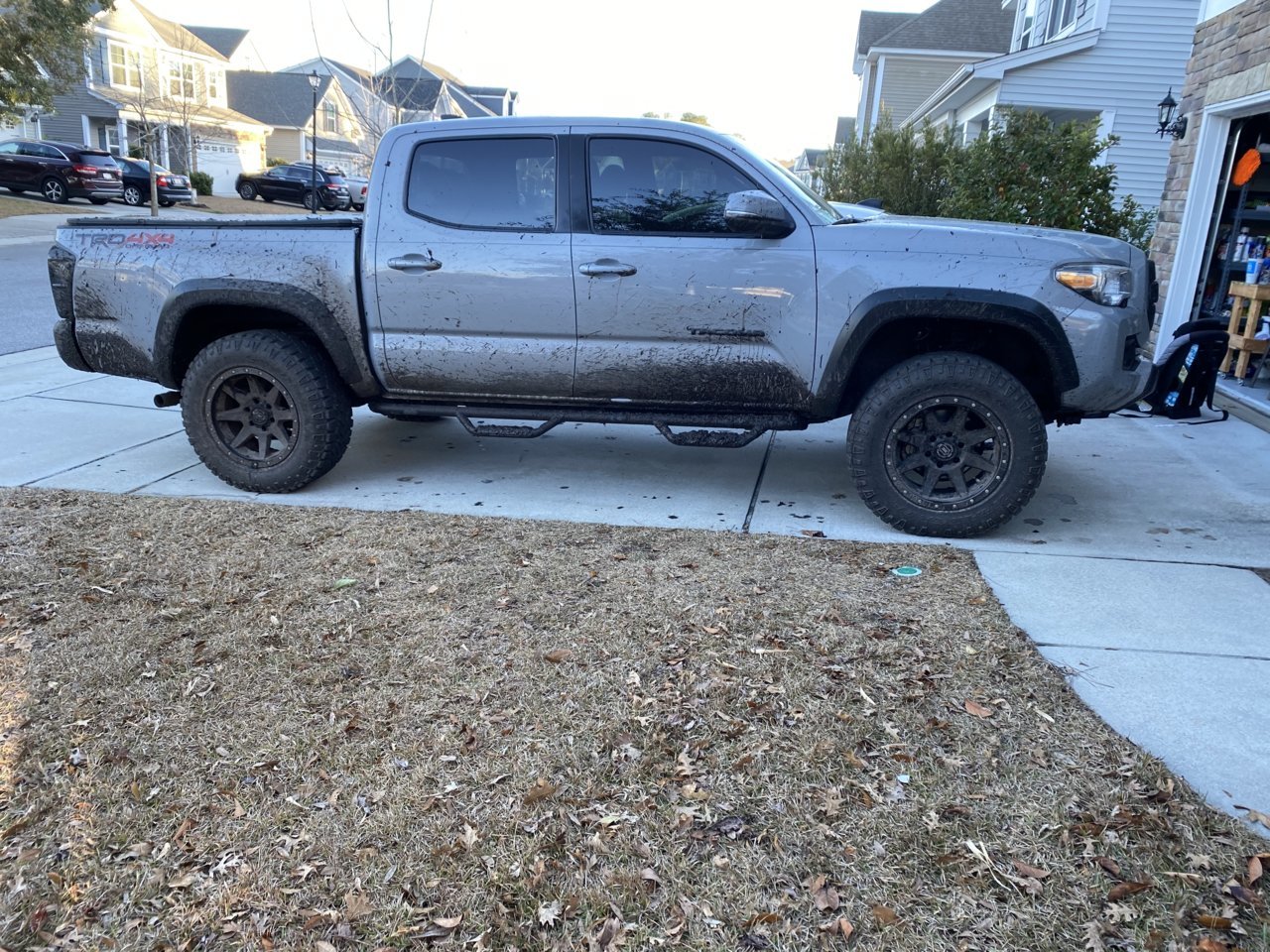

    Ride quality will plummet. I had spacer for a few years (Had a budget) and couldn't take it anymore, and swapped them out. I'd wait until you can afford something better.
  5. Feb 23, 2021 at 3:35 AM

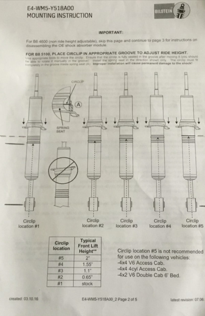

    Chastaco
    Chastaco Well-Known Member
    Feb 29, 2016
    #179794
    1,208
    2020 ORDCSB Cement 4x4 Auto
