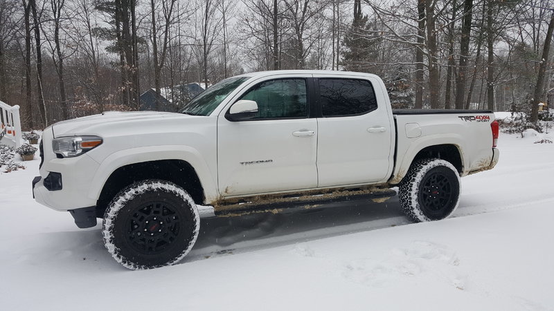

    Depends on if your get the 2nd gen or 3rd gen 5100s. The setting are a little different. The best this is to measure your truck and see how much you need. Each truck is a little different. I have a 2016 TRD Sport SB and my back was about .85" higher then the front depending on how much gas was in the tank. I went with the 3rd gen 5100s set at 2" and also the Head Strong progressive add a leaf in the back. Call or email Marie @HeadStrong Off-Road. She is a ton of help and will get you what you need. Great products and great service from her.
    Here is my truck.
