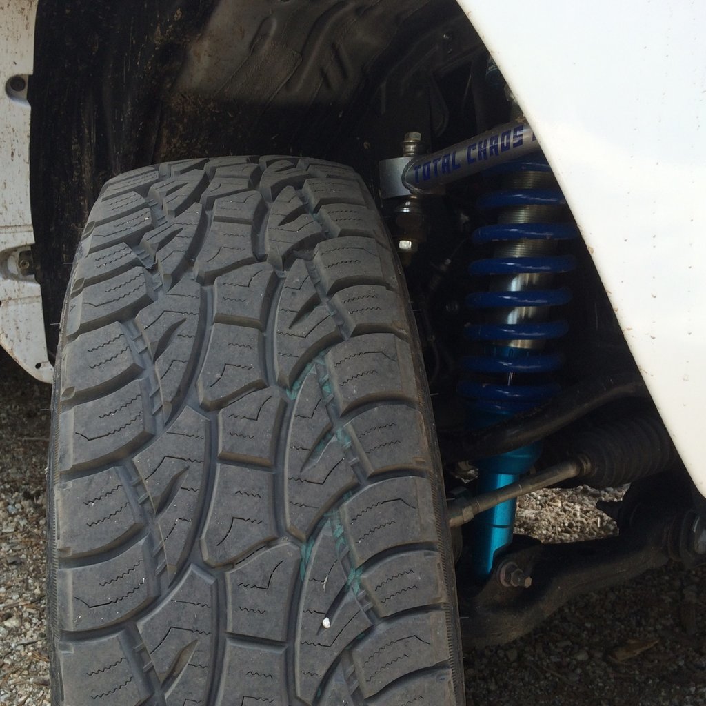

    Better off just spending the money and Get Total Chaos UCAs and King coil overs. I found the cheap shit rides ruff and won't wast long run. I had bilstein leveling and wasn't impressed. DownSouth Motorsports gives good deals for TacomaWorld Members.
    Now the trucks rides amazing.

    Leveled out. Plus ¾" heigher in front.
    King coils overs with piggy back and Total Choas UCAs
