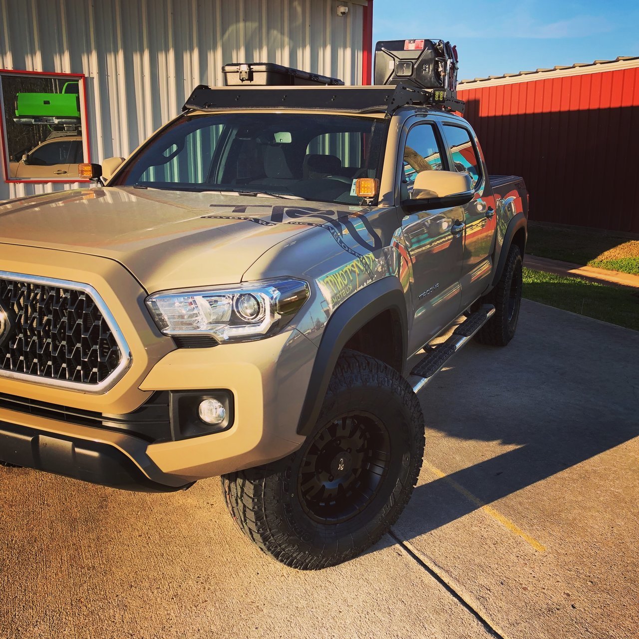

    Depends on what you are planning to use it for.
    I did a whole suspension lift kit since I take mine off-roading a lot. It sits leveled and I am running 33s with no rubbing (did some trimming, but you can’t even tell since my shop painted the plates/weld).

    Cab mount chop?

    Yup.

    Ha ! Having mine done Tuesday . Total chaos has CMC Plates for $20. Saved me .50 hrs at $120 per ! Like to save a few $$$$ plus the shop doing install and chop waspretty stoked about it .
