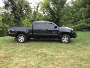

    I just leveled my 2009 last weekend. I used Bilstein 5100 shocks with the stock coils to level it. Set them at 1.75" and it leveled out nicely. Not to mention the ride is much better then the spacers.

    No issues with my 5100's...Seem to ride better than my last shocks, but It probably didn't hurt to replace my shocks anyways, think they needed them.
    7366961f-daf6-46e6-94a4-ecd88cf8844a_zps_497aebfc5f84881cf73ad5907e28d226393bbe77.jpg
