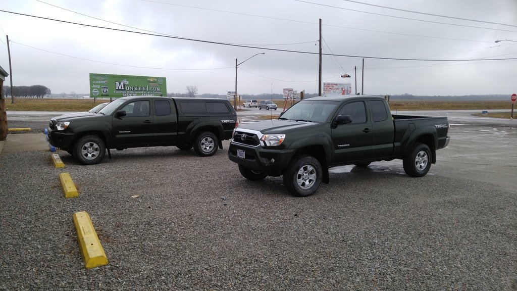

    I know they get a bad rap here but in my TRD Off Road, I put on a 2" spacer lift front and back. I was concerned about the ride and handling.
    I honestly can't tell a difference. The Off Road comes stock with Bilsteins and progressive rate coils on the front so I can't speak to any other models.
    On the rear, I bought the Toytech shock extenders for about fifteen bucks. It still handles well and drives like it did before the lift. I did get the dreaded vibration from the front diff after the lift but the ECGS bushing solved that problem.
    Your mileage may vary. IF you're on a budget, I'm happy with mine.

    I literally can't tell a difference with my 2" spacer lift. I wouldn't go any higher than that and that will get you a little more than two inches in the front since your struts are mounted about 2/3 the length of the LCA from the pivot point to the center line of the wheel. And trust me, this was a huge concern of mine. I have the TRD Off Road so I think the stock suspension was pretty sweet to start with. Yes, it will alter the ride and handling. A 2" shift up in center of gravity will change the handling characteristics. Will you feel it? Probably not.
    I may one day pull my rear spacers and add a leaf but for now I'm pretty surprised with how little it affected the ride and handling. Just don't buy a cheap lift off of e-bay. Buy a reputable brand.
    IN MY OPINION, this type of question is like asking a question in a gun forum about buying the latest CZ. There's always going to be a bunch of people that say buy a Glock, everything else is crap.....
    I also use Fram oil filters.
    Mine's the near one.
