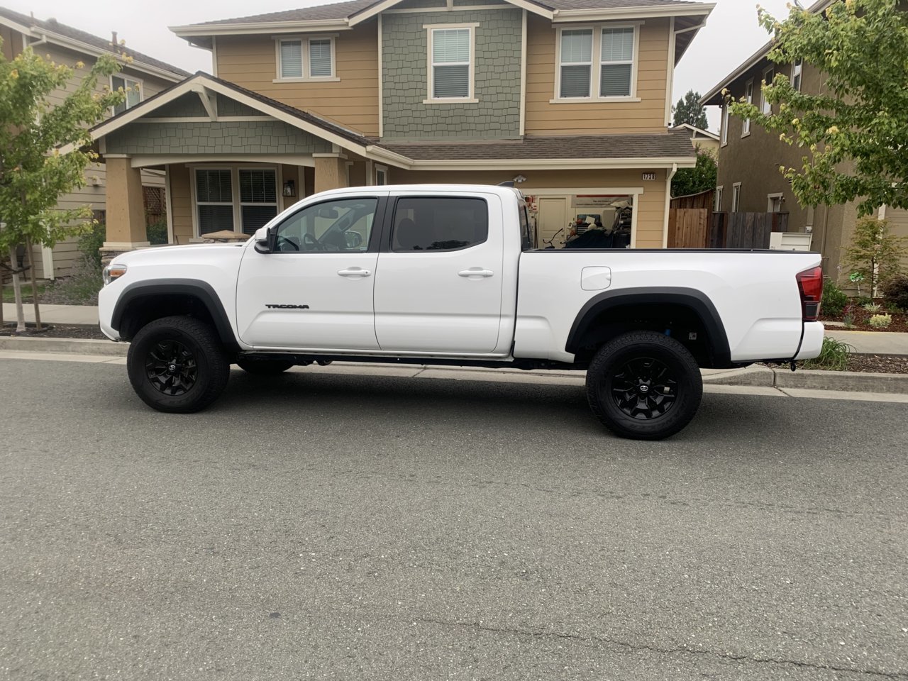

    Pic of the tires

    sorry pic did not upload correctly. Try again

    What you running to clean that?
