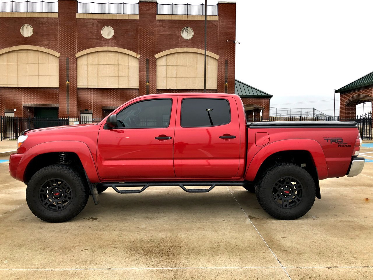

    Toytec Bilstein Adjustable 3″ lift kit eibach springs with 5100 shocks 2” AAL,TRD PRO 4Runner wheels with 33” 285/70/17 Toyo open country AT II, TRD sport grill, Debadged.
    I had a leveling kit I didn’t like it so I got the Toytec bilies 3” adjustable with eibach springs. So much better!
