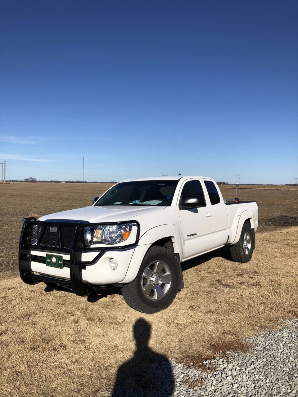

    Hey Tacoma World! Here's my 2011 Tacoma, and i've been thinking about maybe going with a leveling kit and bigger tires on these stock wheels.. so if you can, please drop down your trucks with stock wheels on 33s and leveling kit!

    You might be able to go 255/85/16 or 255/80/17 without too much rubbing. Any wider 33 is going to rub like hell. A less aggressive tire with a narrow tread patch will fit better than a mud tire with treads along the sidewall. The Toyo M55 is 33.5 and fits like magic.
