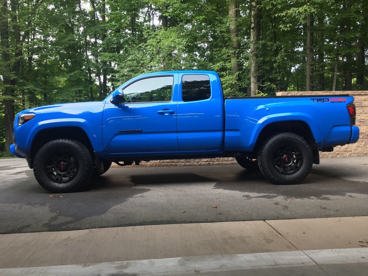

    I bought my Tacoma with low mileage that already came supposedly leveled. I found the nose looked too high and I got tired of it, so I added a block in rear and now it’s great where it measures slightly lower in the front as it should. I still have factory shocks and 265/75 tires. Looks good, rides good. Have not noticed any vibrations or excessive tire wear.
