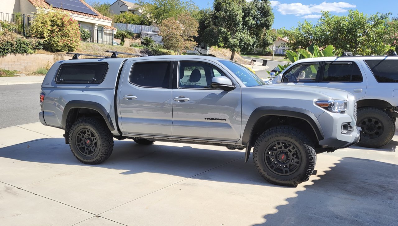

    I did a 1” all around - Streetrays front top plate spacers (no disassembly of the struts required) and 3 leaf progressive AAL in the back. The front spacers are .5” thick, with the geometry of the suspension, they = 1” lift, plus they were only $35. If all you want is a front level, those are the cheapest (and best IMO) option for someone who isn’t going to do anything hardcore, but they will still be fine for plenty of off roading. I’m not normally a spacer lift kinda guy (and have been off roading Toyotas since the mid ‘90s), but in this case, there really wasn’t any drawbacks to doing such a small front spacer on a truck that sees 95% pavement… The spacers are too small to cause any over compression damage to the shocks at all, and there’s no preload on the coils, so the factory ride is 100% maintained.
    The rear AAL is 1.5”, but after the weight of my camper shell, I ended up exactly 1” of lift back there too, so I maintained the factory rake with the shell on. $35 for the spacers + $215 for the AAL, $0 to install everything in about 4 hours myself, so I have about $250 into the whole thing. After having the lift for 1 year, I would do it all exactly the same way again.
    I highly recommend keeping some rake though OP, because as soon as you make a run to Costco, or do any truck stuff with your truck, you’re going to be squatting.
    Tires are 255/75R17 (32x10) Goodyear Wrangler Duratracs.
