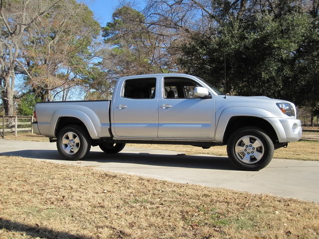

    Just use the stock springs and set it at 1.75", rides great and will save you some money. Here is mine set at 1.75 with the stock springs
