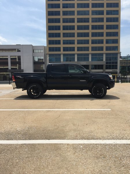

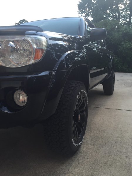

    Alright, so you're wanting to level the truck correct? I would place the 5100's on the .85 notch then, especially if you only have a three leaf pack (pre-TSB). The rear 5100's aren't adjustable, so the back height will have to be achieved through other means. If you have a four leaf pack, the 1.75" setting will give you a better "level". Here's a picture of my truck with the shocks set at .85 with the 1" block in the rear.

    I want my nose to be a tad higher so could I still achieve that with 5100s in front and stock rear end. No aal or blocks.

    Yeah you can raise the shocks to the next notch which would be 1.75". The best way to tell what it would look like is to measure the height of the current setup. Measure from the tip of the fender flare down to the center of the hub. Apply 1.75 inches to that measurement and you'll be able to get an idea of what it'll look like. But to answer your question, you can have the nose sit higher without having to modify the rear.
