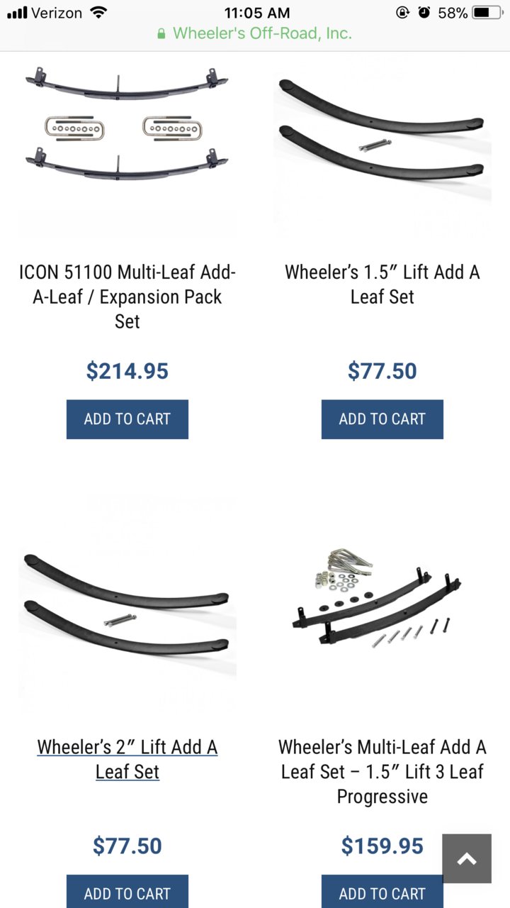

    Am I looking at the right things here? Recommend progressive for smoother ride? don’t do any towing right now.

    Those are the ones! Just get wheelers house brand AAL. I've used their single AALs before and have been happy with them

    Can you try and explain the difference between the options on the page? There’s multi-leaf AAL progressive and then the AAL Set. Multi-leaf progressive is double the cost...why is that?

    You're not annoying me one bit. I'm at work and bored! The multi-leaf AAL progressive is the progressive AAL we've been talking about. This is the one that gives height based on the actual thickness of the leafs, and rides a bit smoother.
    The AAL set is the single AAL that gives the springs more arch, and rides a little rougher. There's two in the picture because there's one for each side.
