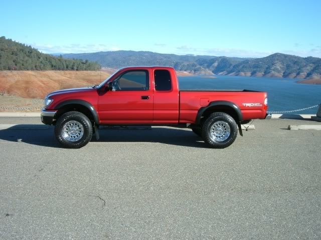

    Sway 2.0 coilovers front leveled w/ stock rear leafs w/ Bilstein 5125 shocks...16 x 8" Pro Comp's w/ 265/75R16 A/T:

    Man that is a sweet lookin truck, I had a 93 pickup that same color.
