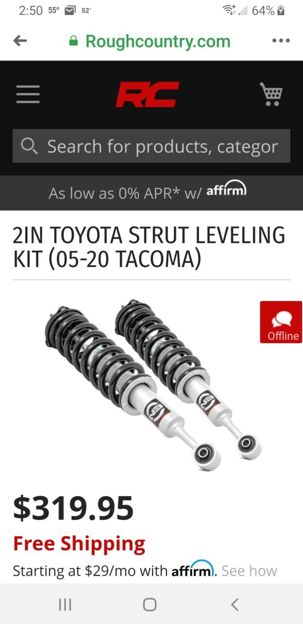

    Thinking of putting the Rough Country 2" leveling front shocks in my truck and new shocks in the rear....do I need to install a diff drop also?

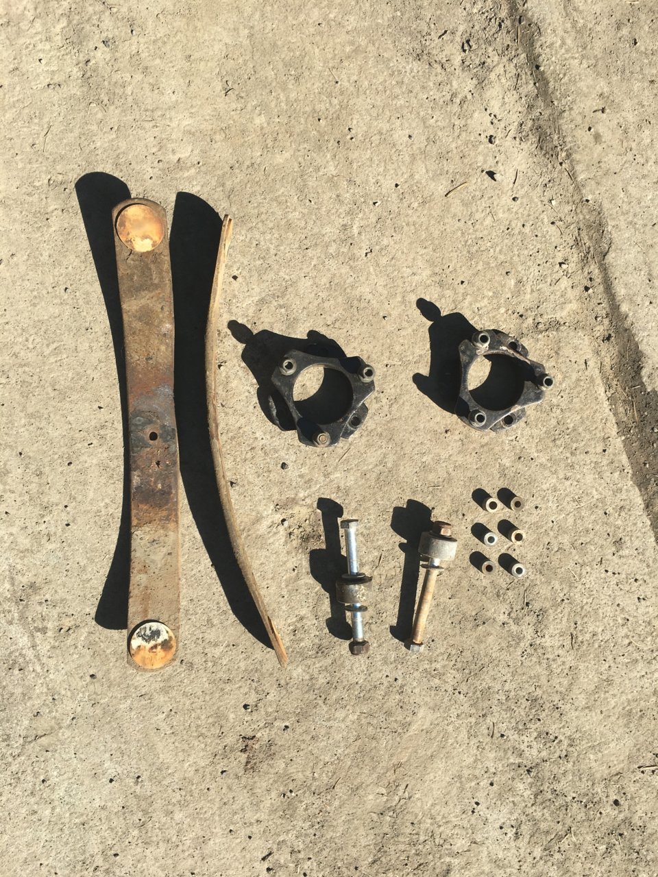

    I know it’s not what you were asking, but I have a spacer and add a leaf kit for sale. Includes diff and skid drops. No rear shocks, but it Might be a cheaper way to accomplish what you’re after.
    $50
    Edit: $50 + shipping

    Rough country isn't exactly known to be the best brand and when you can buy OME 884 coils (or Headstrong 2 inch) paired with bilstein 5100s for about the same price as those and have a MUCH better product it just doesnt make sense.

    This is essentially what I did with my truck. Got Bilstein 5100s with a 2"HS coil. You can buy this exact front setup for ~370 from Headstrong offroad. Another ~300 and you can get 5100s for the rear with an AAL.
