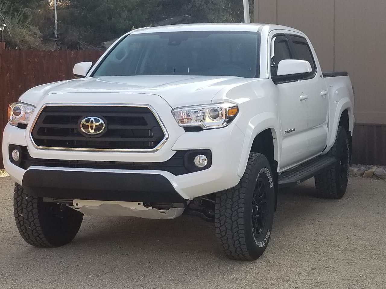

    20200920_084809.jpg You will be nose high with a 2" level lift, I had to add a 1" block on my chicks mall crawler. It has about 1/2" rake now.
