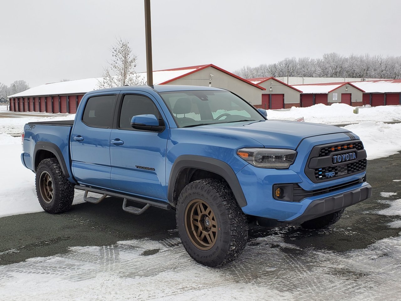

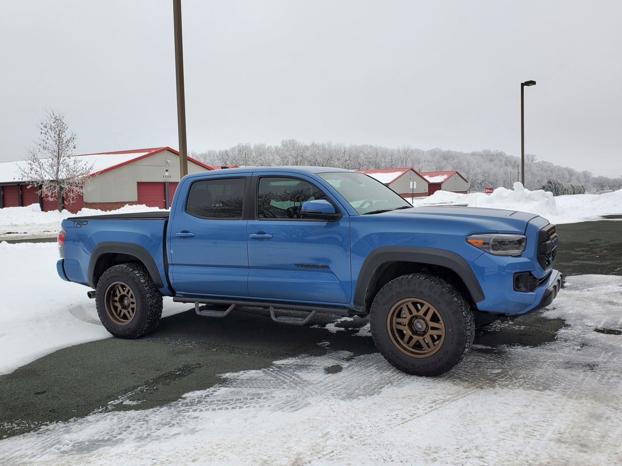

    Here's 265s on stock suspension with -10 mm wheels.

    Welcome to the forum! If this is for a daily driver that may occasionally see a trail and you only want to level then you may want to play it safe with 265/70's like previously recommended. There are many with actual 3" lifts that still had to do inner fender, body and/or frame modifications to keep 285's from rubbing as also previously stated. Also when you get around 3" you start running into possibly needing to replace your upper control arms for alignment and potential contact with the tire depending on wheel spacing. Just something to think about!

    This is exactly why I decided not to get any sort of a lift.
