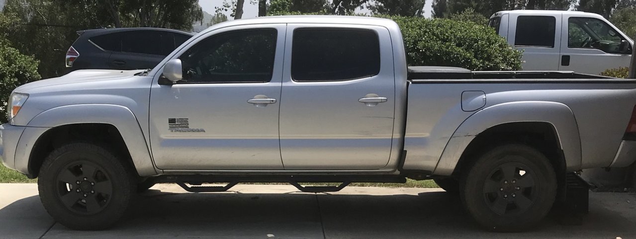

    In this picture the truck has a 2.5” lift up front and the same 2” lift in the back. The tires are 265/70/17s.

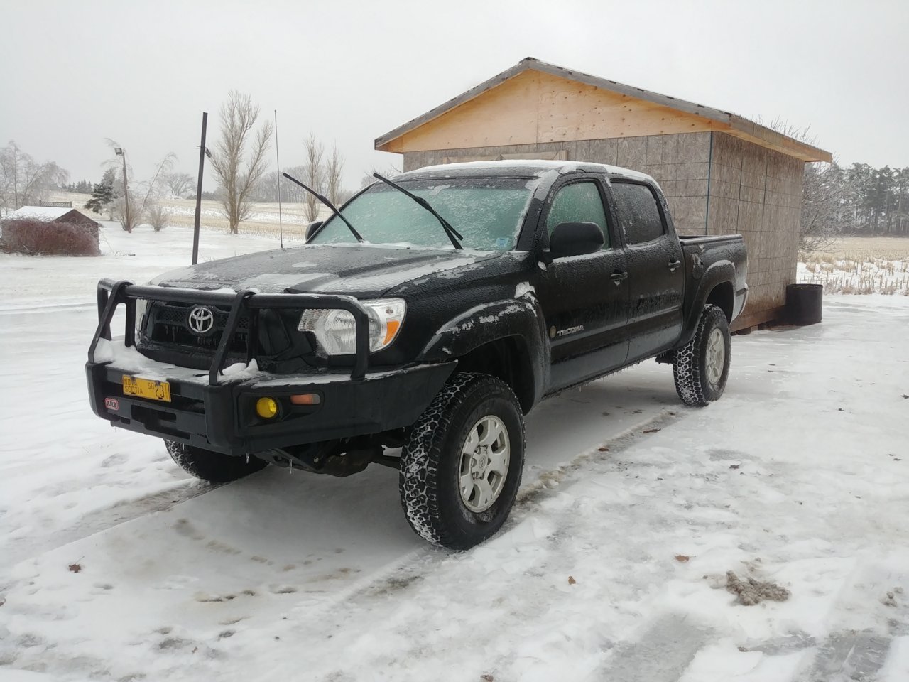

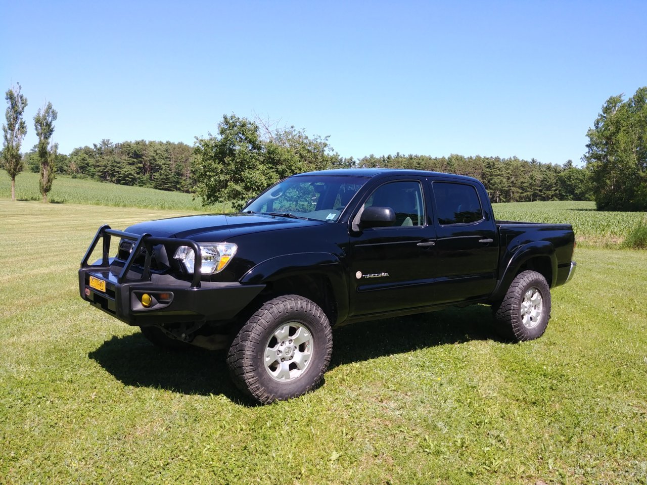

    20190707_152146.jpg 20200207_153425_HDR.jpg 2" spacer in the front. 1" block in the back. 285/75-16 in the top pic. 235/85-16 bottom pic.
