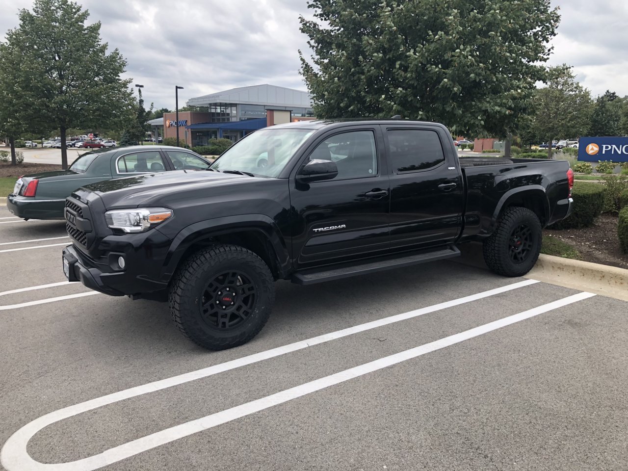

    And yes sir I got the 17’s TRD Prob FJ Cruiser Wheels with Fallken 265/70/17 tires and so far I love it
