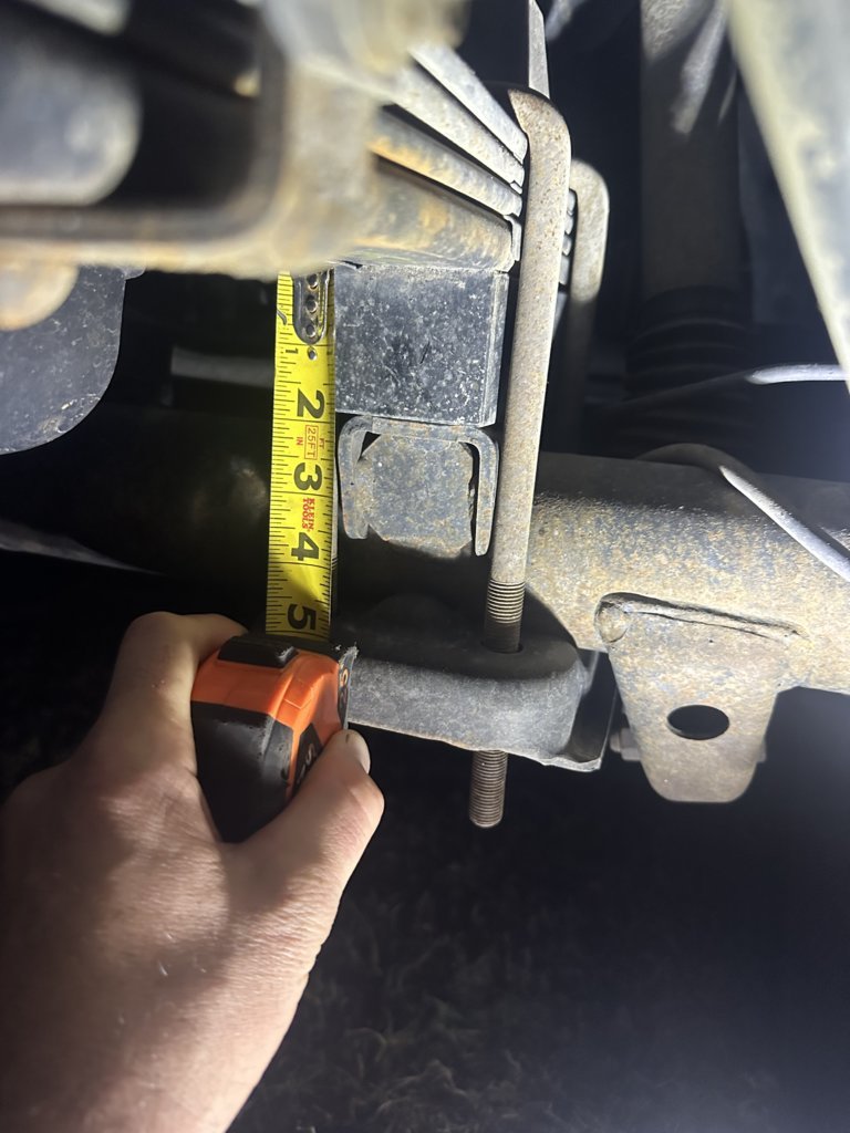

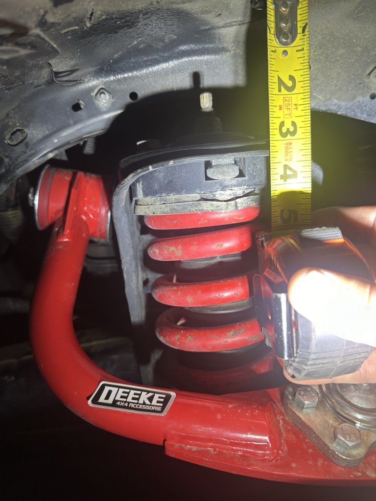

    I am trying to figure out what lift I have, I have some pictures of the leveling kit.
    I am experiencing bouncing with my new control arms(3 inch lift arms) I’m wondering if I need to go back to a factory control arm. IMG_0126.jpg IMG_0128.jpg

    Any alignment specs post install of UCAs? Lift looks like standard 3/2 level kit. Not sure what coils those or the spring rate. Are you saying it didn’t bounce prior to?

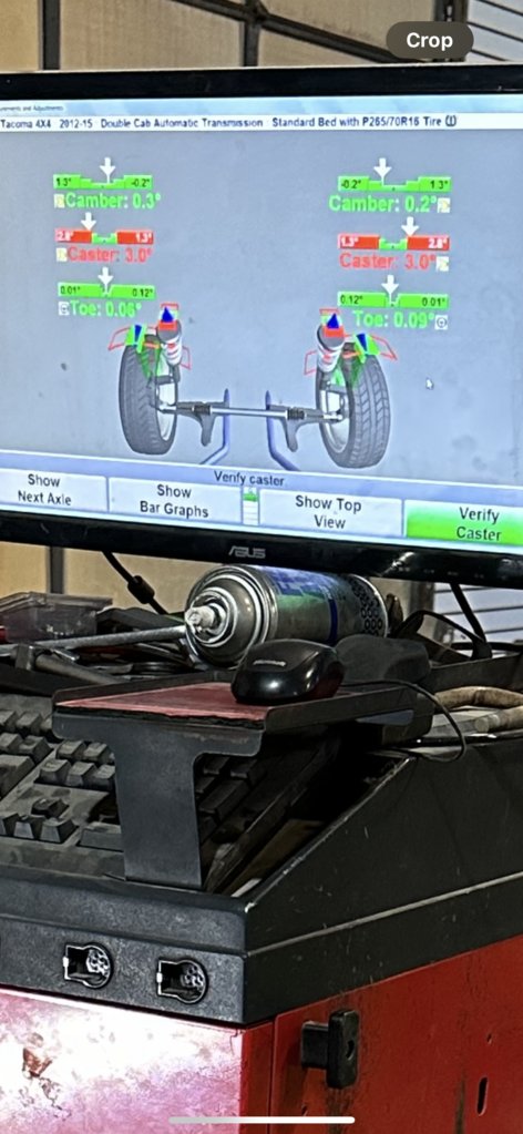

    This is the alignment after I installed new Lca’s that the shop said I also needed, after he couldn’t get it right after new uca’s

    What’s the alignment # post ucas?

    These #s really aren’t bad with 3” of lift on oe ucas.

    This is with the aftermarket uca’s.
    However the bounce wasn’t there with factory uca, so I’m unsure if I should just get factory control arms, or get new shocks/struts I am unsure on spring rate

    In theory wouldn’t the added caster actually give you a little less preload?? Not sure it would be noticeable though.. need smarter people to tune in

    Explain what you mean by bounce. Do those ucas have caster built in? Usually the isssue you explained is poor caster or high angles on the tie rod ( bump steer). But if those are the alignment #s post new ucas and lcas they’re really aren’t bad. Who installed the ucas and lcas and were they torqued under load?
